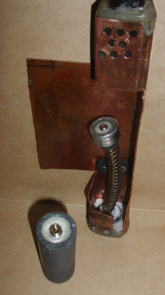

OK, this isn't going anywhere - the forces involved are a bit too much.
Here it is at 5x, really weak in terms of power, it destroyed the thick rubber extractor while still slightly chipping the cartridge, and to top it all off the cartridge knocked the camera over :roll:
I added a spacer to the spring to increase compression and gave it a whirl at 7x, this time with the camera out of harms way. Again, just a dent in a steel sheet but it destroyed the rear epoxy endcap and bent the bolt itself out of shape.
Here's the damage, back to the drawing board...

I think you may need a thicker bolt or better support for it somehow. it seems that that bolt rod is extremely flexible, and susceptible to bending as a result.
CpTn_lAw
Posts: 987
Location: France
Maybe use a tougher spring? Maybe use a prolongation tube, in which the cartridge goes, so that even when it begins to cycle, gases continue to be pushed in the only way possible : the barrel.
Posts: 3643
Been thanked: 62 times
What about an air spring? A telescoping cylinder... should be within reach in terms of either building such a thing or using a purpose-made pneumatic cylinder.
I say because threaded rod/bolts are usually more flexible than equivalent sized tubing, or so I've found when building my pump. :roll:

JSR is so not going to listen to any of you that he's going to take the cartridge to 8x and blow up the breech :D

I suggest that you may be able to solve all of the problems by changing the design of the bolt housing, and making the bolt far thicker. Using a much thicker bolt, it could retract into a rear cylindrical housing with a close tolerance, and enclosing the spring entirely in the housing. As I hope you're aware, it's possible to purchase springs with insane spring constants on McMaster...
