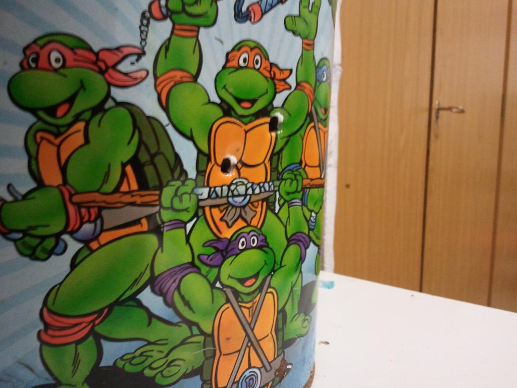

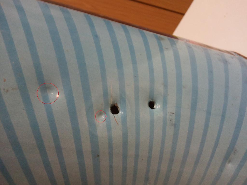

some damage photos using airsoft BBs:
The red circles indicate holes from a 4.5mm air rifle using pointed Gamo pellets
6mm steel BB (the airsoft BB did no damage)

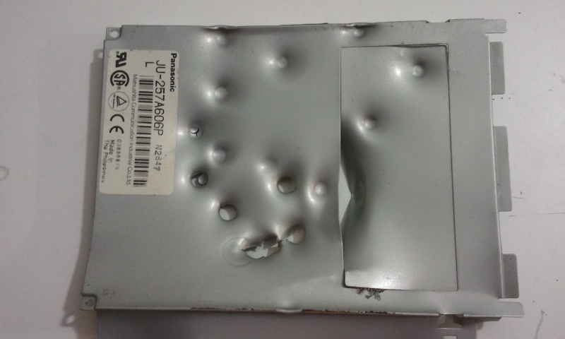

Various steel and airsoft BBs fired at a steel disk drive casing:
red circles indicate airsoft BBs, blue circles indicate steel BBs at 210 psi, yellow circles indicate steel BBs at 400 psi:
Detail of steel BB at 400 psi showing a perfect circular penetration:

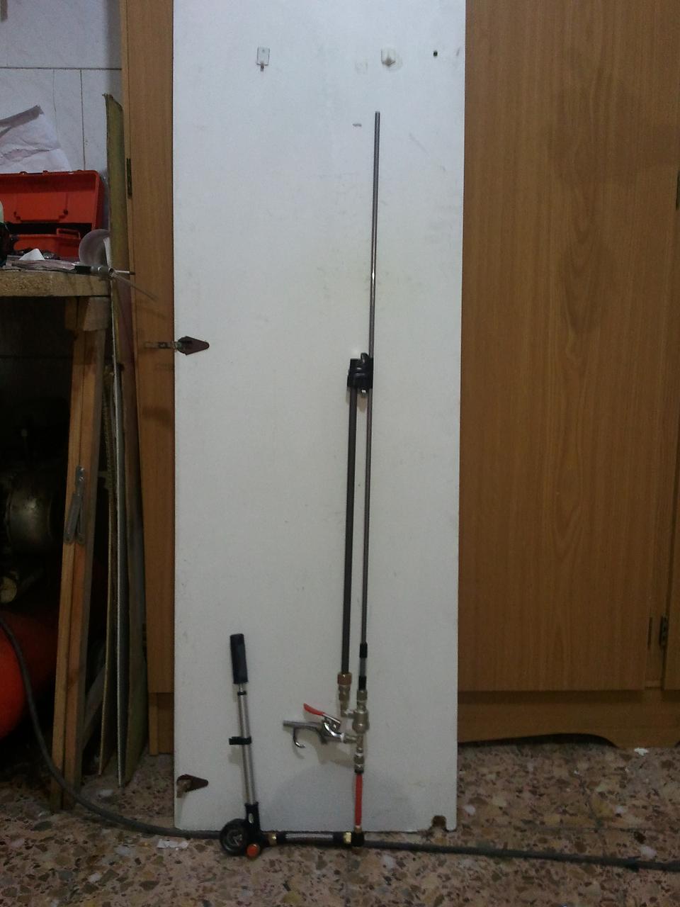

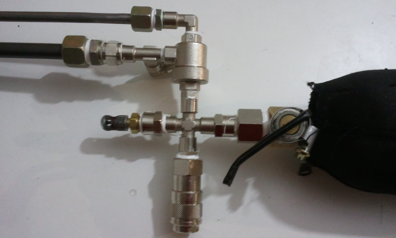

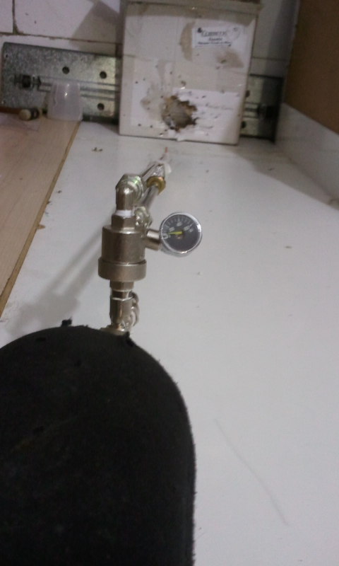

Nice! Some more information on the pilot and fill setup for the "current state" would be nice. For instance, is that a tank acting as the "stock"? Does your pilot close off flow from the tank when piloting? Etc., etc...
Good job nonetheless. I can only suggest cleaning up the spacer towards the pressure gauge between the chamber and barrel. A hose clamp shrouded in some rubber tubing (or just the hose clamp if it doesn't bug you) would work fine.
<s>I have not studied Spanish for over two years, so unfortunately Google translator will have to do the work for me.</s>
EDIT: This translates funny. Suffice to say I don't know Spanish.
Posts: 26220
Been thanked: 352 times

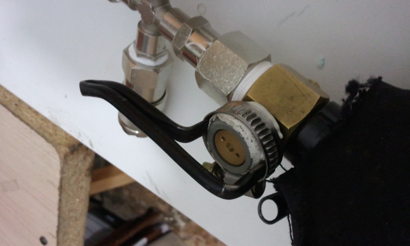

mark.f wrote:Nice! Some more information on the pilot and fill setup for the "current state" would be nice. For instance, is that a tank acting as the "stock"? Does your pilot close off flow from the tank when piloting? Etc., etc...
The firing chamber is under the barrel, while the CO<sub>2</sub> tank (filled with compressed air) is the main chamber. The firing chamber has to be manually refilled for every shot.
The pilot is a simple schrader valve, covered with a cap that depresses the stem.

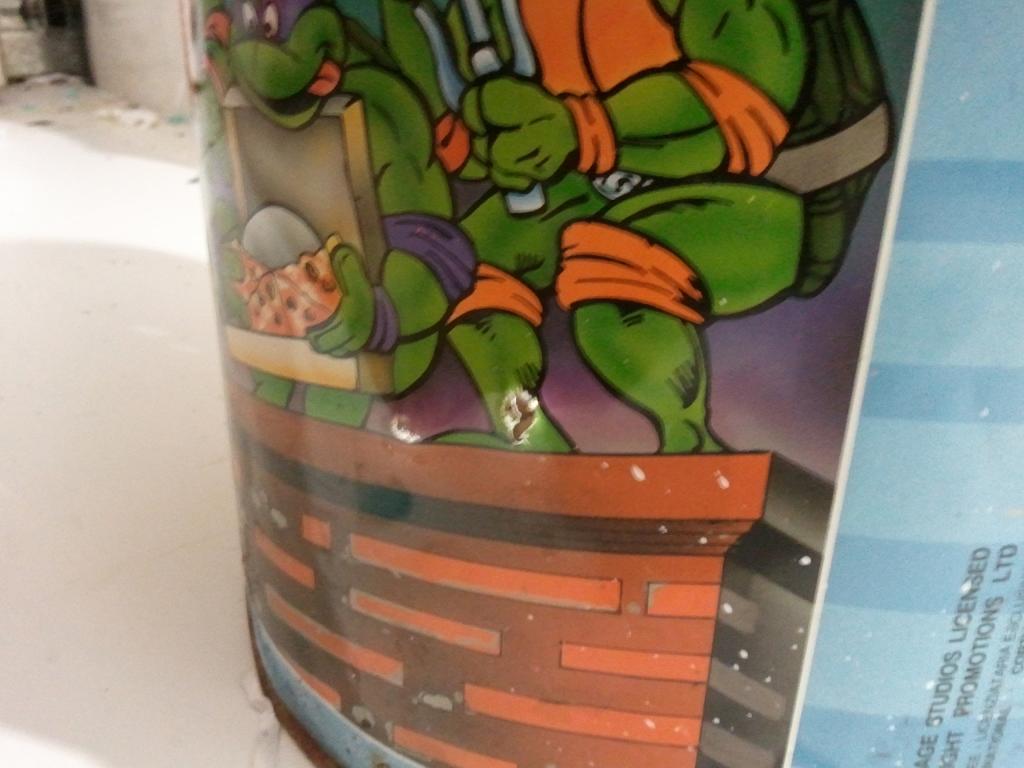

On an unrelated note, one of the targets reminded me of a joke:
I've just been attacked by a Teenage Mutant Ninja Turtle.
Ironically, he wasn't wearing a mask so I don't know which one it was.

I see. What pressure is the CO<sub>2</sub> tank filled to? I assume 450 PSI or thereabouts due to the shock pump, but I could be wrong? Is the tank regulated to the guns operating pressure?
Any ideas on the chamber volume so we can get an idea of shots/fill for the reservoir?
Lots of questions, but you seem to know the answers.
Posts: 26220
mark.f wrote:Lots of questions, but you seem to know the answers.
I was consulted during manufacture :wink:
He's using a fridge compressor to fill to around 500 psi max, no word on how many shots per fill. The tank isn't regulated though so the power curve is relatively steep, I don't expect more than 5 or so useful shots at 500 psi.

mark.f wrote:Good job nonetheless. I can only suggest cleaning up the spacer towards the pressure gauge between the chamber and barrel. A hose clamp shrouded in some rubber tubing (or just the hose clamp if it doesn't bug you) would work fine.
it is far from finished.
Tenias un papel albal y cinta aislante a mano xD
jackssmirkingrevenge wrote:La camara principal esta a 500 psi y tu presurizas la camara de disparo solo hasta 200 psi? Si es asi, como lo haces, manualmente? No hay un regulador entre los dos camaras, verdad? 50 disparos es impresionante.
En un futuro el palo negro se alarga asta cañon simulando un cerrojo de sniper. (ver la foto de abajo)
Hoy hice pruebas:
botella co2 casi 600psi, regulado a 200psi 42 disparos efectivos, luego -200
9 disparos de 600psi asta 400psi muuuuy fuertes :twisted:
El rango optimo de disparo esta entre 390 y 200psi
tengo que hacer el silenciador YA! me voy a quedar sordo
jackssmirkingrevenge puedes traducir esto de abajo por favor ?? si pueden decir el volumen en ml mejor xD
¿¿sugerencias para disparar mas fuerte y menos consumo?? estoy por hacer 2 camaras en linea una primera mas pequeña para disparar a maximo psi y otra para disparar a 200psi separadas por una valvula de bola.
La camara en total mide 40cm y tiene un diametro de 8ø y el cañon 70cm 6ø
