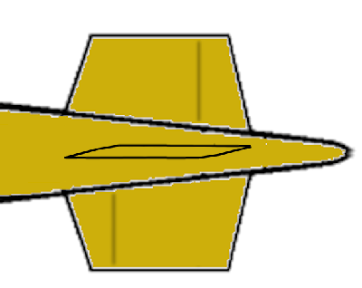

Yea it will, your not trying to make it like a plane wing but more of a propeller. Still i think it is unnecessary and probably wont have much affect on the projectile.
Ah, gotcha the propeller's idea!
It's really not a big deal to add, so why not.
I think the Tall Boy fins where bended to induce this rotation. Now where did I read that... JSR, were are you when we need you!?
[edit] Ah yes, Wikipedia say the fins were given a slight twist so that the bomb spun as it fell. I cannot do a twist accurately (I would need to design some specific jig for that), but I can do the bevel.

The problem with optimised projectiles is that when well done, they are usually too beautiful to shoot.
As to inducing rotation, I personally wouldn't - ie fins must be parallel to the centreline and their edges should be tapered symetrically. Rotation uses up forward kinetic energy, increasing drag and reducing velocity retention.
