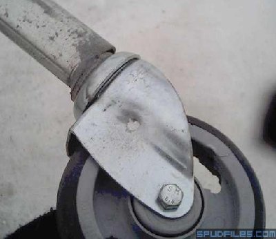

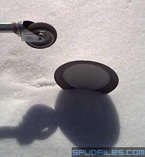

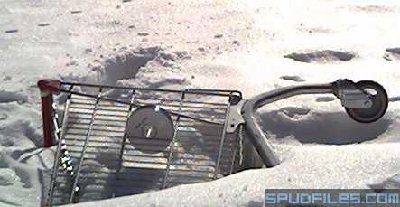

There is a shopping cart stuck in the ice at the lake, which I used for target and support. first shot was through the wheel, which was no match at all. - valve.jpg (16.55 KiB) Viewed 16986 times
- I did some range shots with a relatively flat trajectory, I think I can shoot across the lake at good elevation (400m) but there's popular a hiking trail all the way around it so I won't try. The lake is about a mile long so I can do range tests that way when there's no people on the ice, but I don't have any way to see where the marble lands. A smoke marker or something would be nice...
Another shot at the bars of the cart bent one of them out of shape. - wheel.jpg (6.46 KiB) Viewed 16986 times
- A second shot through the middle split some of them in to, and broke a large hole in the middle of others.

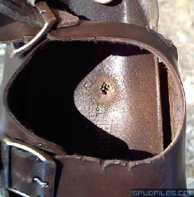

First, I decided to take it out on an old sandal - marbledamage.jpg (1.76 KiB) Viewed 16986 times

I went out and did a few more tests, because I wondered if I could shoot through the leather on the top of sandal. That was no problem. - sun.jpg (9.64 KiB) Viewed 16986 times
