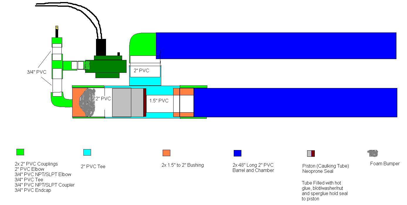

I designed it in paint, and I think that it should work, but I want to run it by the experts before I actually make it.
I plan on the piston being a duct tape wrapped caulking tube filled with hot glue, and the seal being attached with a nylon bolt and super glue. The bumper will be made out of some foam insulation.

The piston valve design

Just to verify, is the bottom or the top piece of 2" pipe in that diagram the chamber? Spudfiles is going all wonky on me and won't give me the larger view of the diagram, so sorry if you mentioned there.

Oops, should have labelled that.
Its a barrel sealing piston, so the top blue pipe is the chamber.
Thanks for catching that.
:oops:
Posts: 3643
Been thanked: 62 times
Then yes, it should work fine. You will have to perform some modification on that bushing to allow it to pass farther into the tee and allow space for the 2" barrel, though.

Diagram looks good except for a couple things. I would take a look a gun freaks superna. Your pilot volume is a bit big as well as that piston will not work up to the guns full potential. I personally make a version of hubbs piston valve.

If you plan on keeping that massive pilot volume I would move up to a 1" sprinkler valve. However I recommend just configuring the pilot a bit differently to make less volume like I did on Superna (link above). Oh and also I don't know if the fitting to the left of the tee is a female adapter or a slip coupling, but just for clarification it should be a female adapter which enables the use of a threaded bushing so you can service the piston. Other than that... it looks like the run of the mill 2" piston valve :P Good luck! Keep us posted, and if you run into any problems or aren't sure on anything, just ask one of us :wink:
Many excellent points are already pointed out. An additional item is in regards to the location of the valve seat where the piston and barrel breech meet. The diagram shows the valve closed centered in the T. It looks good on paper but it is not the best location. You want the gap of the OPEN valve centered in the T for best flow when open. Since the piston moves and the valve seat does not, this would place the valve seat off center in the T so it is near one side.
If for example the piston opens so the gap between the piston and valve seat is 1/2 the valve seat diameter, then when open the piston would extend 1/4 the way into the T from the breech and the barrel seat would extend into the T 1/4 the way from the other side. When closed the piston would reach 3/4 the way through the T to the seat.
If possible use a larger T so the valve seat is the full barrel diameter so the valve does not choke the flow when open.

Thanks for the suggestions so far.
I'm going to try to reduce the pilot area. If I can find a 1/4" NPT Schrader valve, I'll thread it directly into the sprinkler valve like Gun Freak did. If I cant find one, I'll just attach my current fill valve into a 3/4" tee between the back of the piston housing and the sprinkler valve.

Regarding the piston position, is this what you mean? (New diagram includes reduced pilot area and larger bumper)
Reduced pilot area, bigger bumper, revised piston position

Gun Freak, thanks for the pointer. However, I just took apart my Lawn Genie sprinkler valve and have determined that the best place for the valve is in the center of the bottom. (Its flat)
pomplemus wrote:Regarding the piston position, is this what you mean? (New diagram includes reduced pilot area and larger bumper)
Umm, somewhat. You overshot the postion. Push it back into the T so the closed gap is off center but still in the T and not in an end.

So the 1.5" PVC should stick into the 2" tee a measure between the original and the edit? Like This?
The way I understand it, the gap between the piston sealing face and the barrel sealing face when open should be 1/2 the diameter of the interior of the tee. (2.375/2=1.1875")
EDIT: Wait, I think I get it now. You don't want the open gap to be smaller than the barrel seat, because that would reduce flow, At the same time, you don't want it to be bigger because that would introduce needless dead space. In my case, that is 1.5". (The diameter of the piston seat)
Am I Right? :D
Piston in Open Position
The new drawing is correct. The big problem with it too far forward is when the piston is opening, it is blocking flow to the barrel until the piston pulls out of the end of the T.
