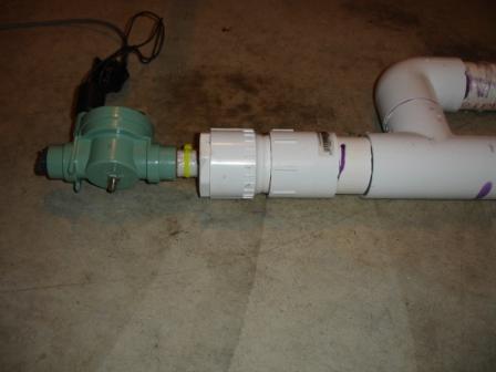

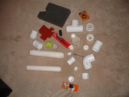

Until then, some pictures of my progress. The second Schrader valve sticking off the chamber is there just because I didn't have a threaded 3/4" plug handy.

- The parts I started out with
- DSC05976.JPG (20.49 KiB) Viewed 4124 times

- Close up of the fill valve and pilot area
- DSC05978.JPG (16.6 KiB) Viewed 4124 times
