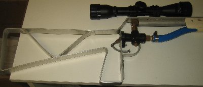

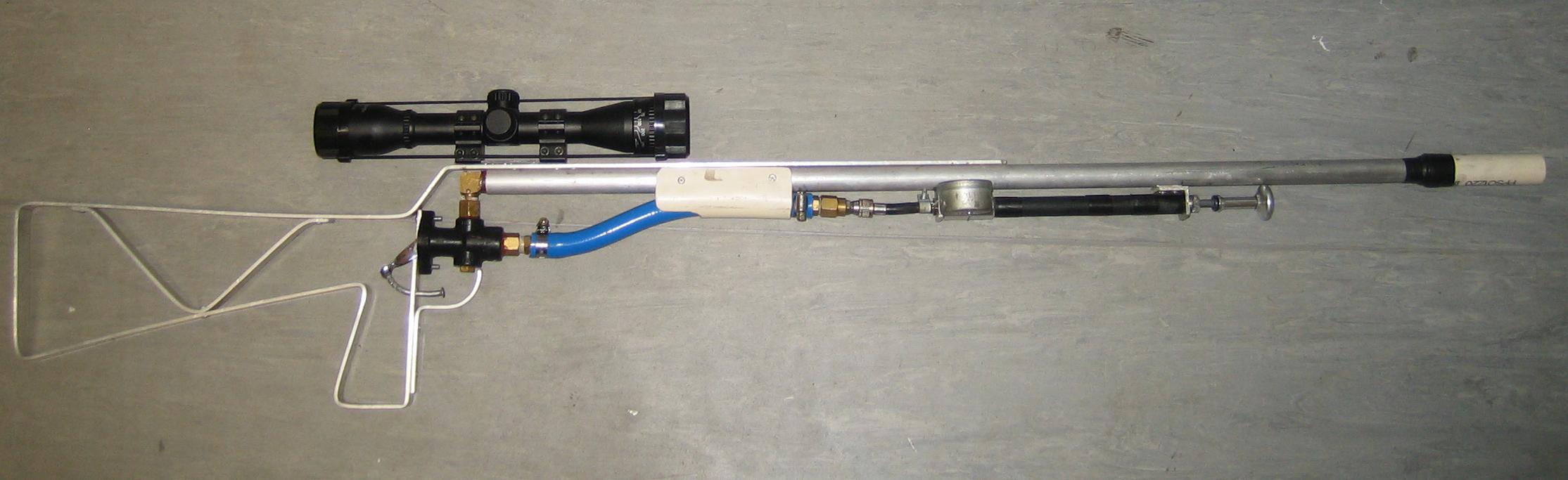

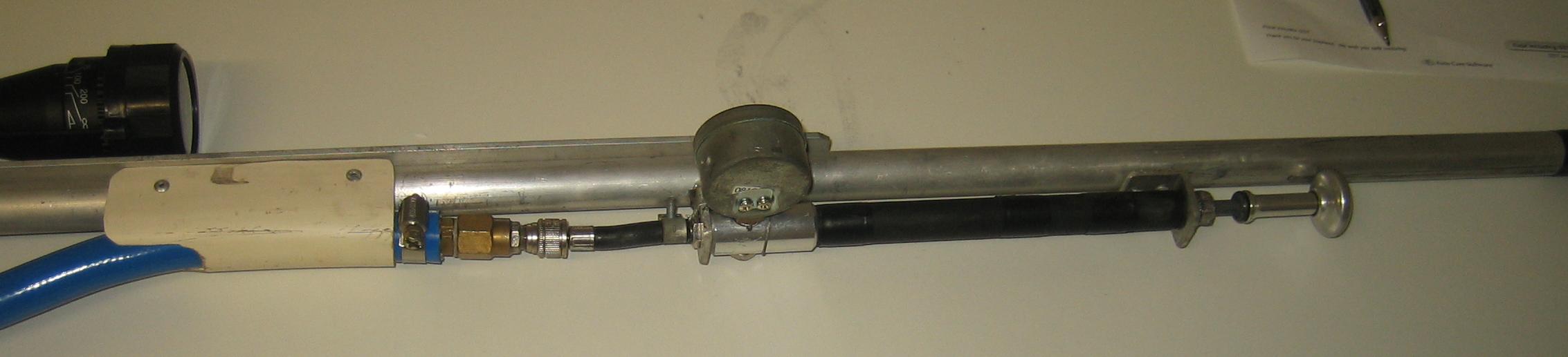

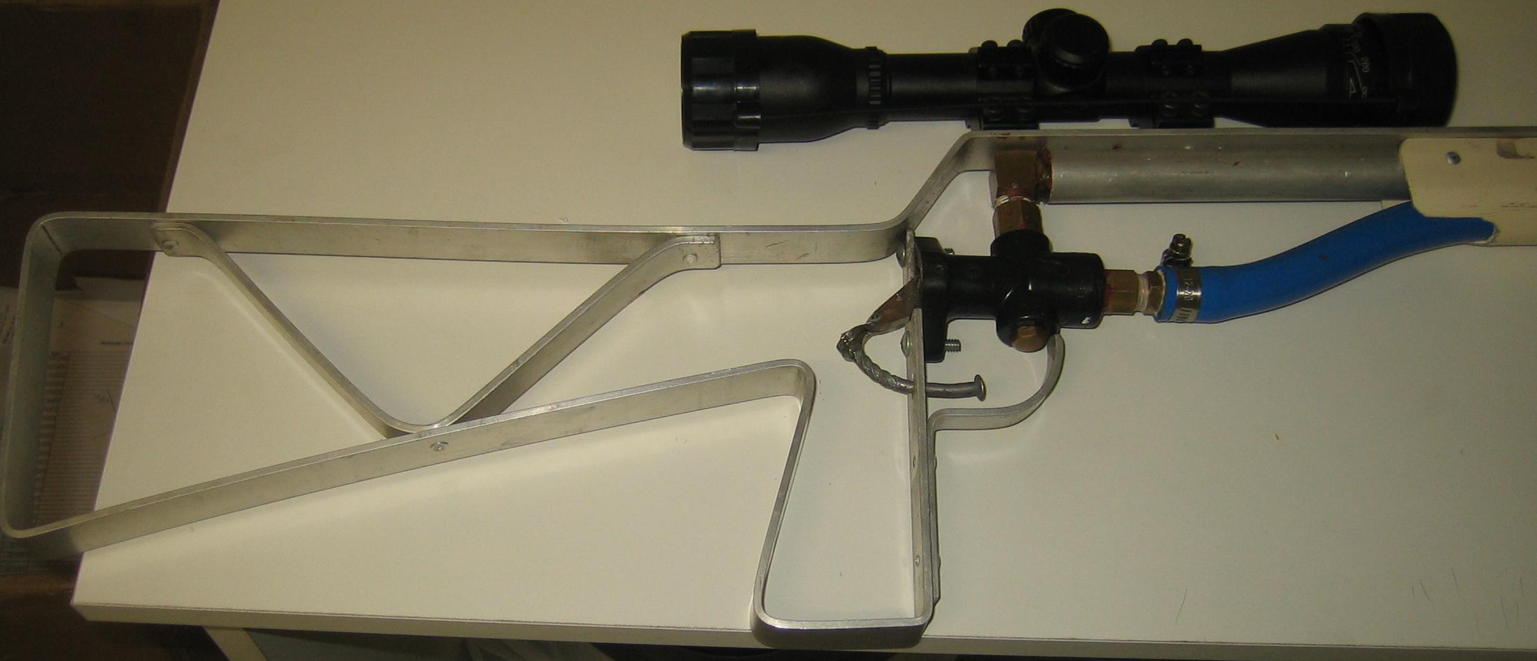

This is my first post, sorry for any mistakes. My work mate and I built a couple of variations of this gun last year for [COMMENT REMOVED BY BTB ]in and around the shed where we work.
There's nothing remarkable about this gun, it's simple to make, but I haven't seen any on this site that use this kind of release valve so I thought I'd put a few photos up in case it gave anyone ideas.
The release valve is an air brake valve used on big trucks (some semis, dump trucks). This one was brought brand new but the first gun we made we just pulled one out of an old truck cab.
Air is supplied via a shock pump, we do have one with a soda stream bottle mounted which we fill with an air compressor, but it's easier to walk around the shed with the hand pump model than to return to the compressor between shots.
The air chamber is just a length of air compressor hose you can buy off the roll. We experimented with different lengths and what we ended up with seemed to give us the best power/number of pumps ratio.
It fires 1/4" ball bearings and it is loaded through the front of the barrel. The pellet cannot fall out unless the rifle is tipped completely upside down, so you can shoot at downwards angles. It is a single shot gun, no magazine.
I can't think of any special tools required to make this, just a drill, rivet gun, screwdriver, hacksaw.... I think thats about all.
I usually only pump this up to ~150-200psi. Can plink a paint can pretty good at ~80feet, although most of the other shots I take are 1/2 that distance to make up for my lousy aiming.
So overall an easy gun to make for beginners. Now I'll try and upload a couple of photos.
Thanks for checking it out, feel free to ask any questions if you like.
PS if you're wondering why I don't just use an air rifle, welcome to Australia, my friend, where anything other than a pointy stick needs to have a license.

First Rifle (1/4" BB) - Simple design w/shock pump

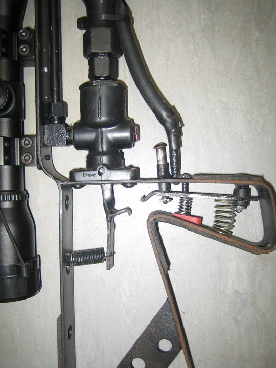

Never had much to do with trucks, So this is new to me... but the usual QEVs we see are only rated to about 145 psi, and people take them much higher.. Id be interested to know if something designed for truck brakes was a bit more robust.
As for giving you too much credit Cane Toad - I dont think so - you've taken a valve you had access to, used it well and came up with a simple and elegant solution that I haven't seen here before. If all you did was weld on a bent nail to make an ergonomic trigger - That's even better!
So its a manually operated 3 position switch, That got possibilities too, Its not what I first thought, but could be interesting none the less, Now if only the lever indicated which gas port fired
But, You could still get the result I was thinking about with your setup - simply put a spring behind the head of the nail and in front of the frame of the grip - that way when you pull the trigger it would automatically reset to the of position when you let your finger off.
Then - if instead of a finger pushing the trigger open you use spring driven hammer, you get the momentary opening and closing thats required for multiple shots.
Then all you need is a bolt action that cocks the hammer and works a loading mechanism and you've got a multi shot plinker that you built yourself! None of the "inanimate targets" around your yard would be safe then!
Now its true you could use a QEV for all this, I just like hammer valves better than I like piston valves, maybe i'm just odd.
Id really like to see some Pics of the "other" more complex build you mentioned - with the spring loaded trigger with a sear. That sounds really neat!

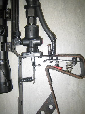

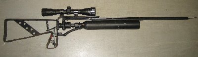

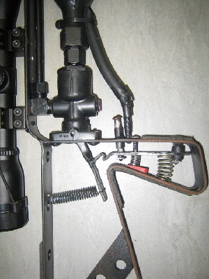

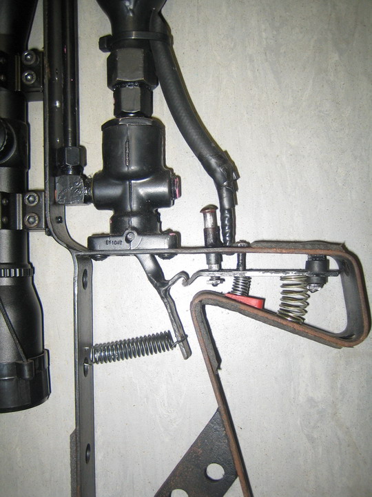

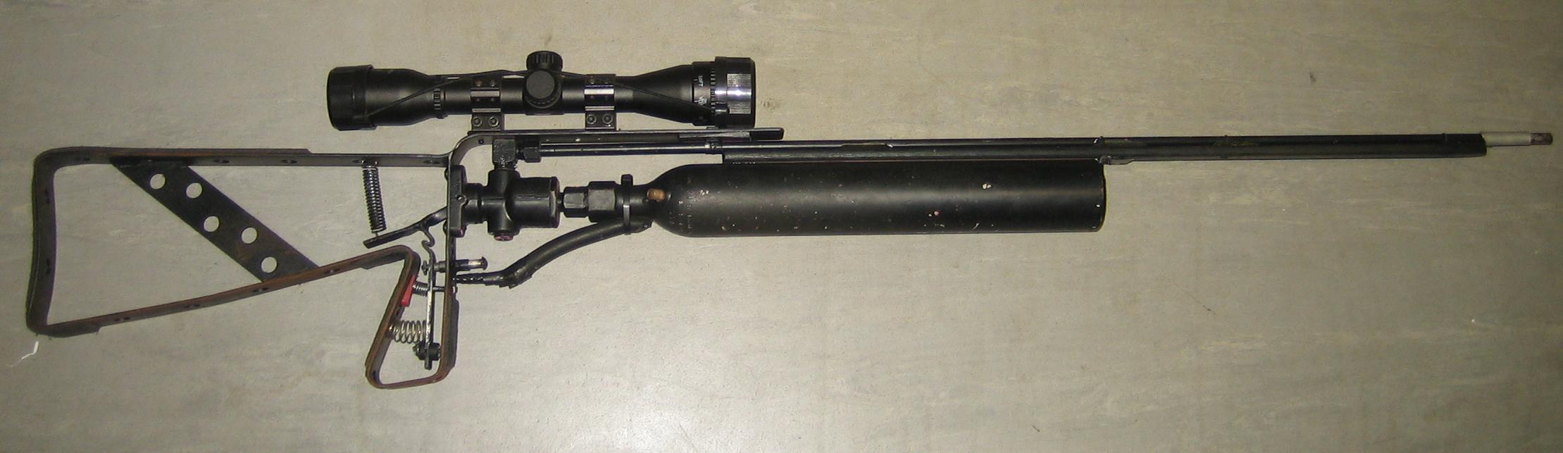

Here's a few pics as requested of the other rifle I mentioned. Same principles only with a spring loaded trigger held by a sear, and a soda bottle air chamber.
As you'd guess, the spring loaded trigger does improve the power.
Thanks again for the comments/suggestions.
edit: The trigger guard was meant to be temporary, made from scrap, never bothered changing it.
