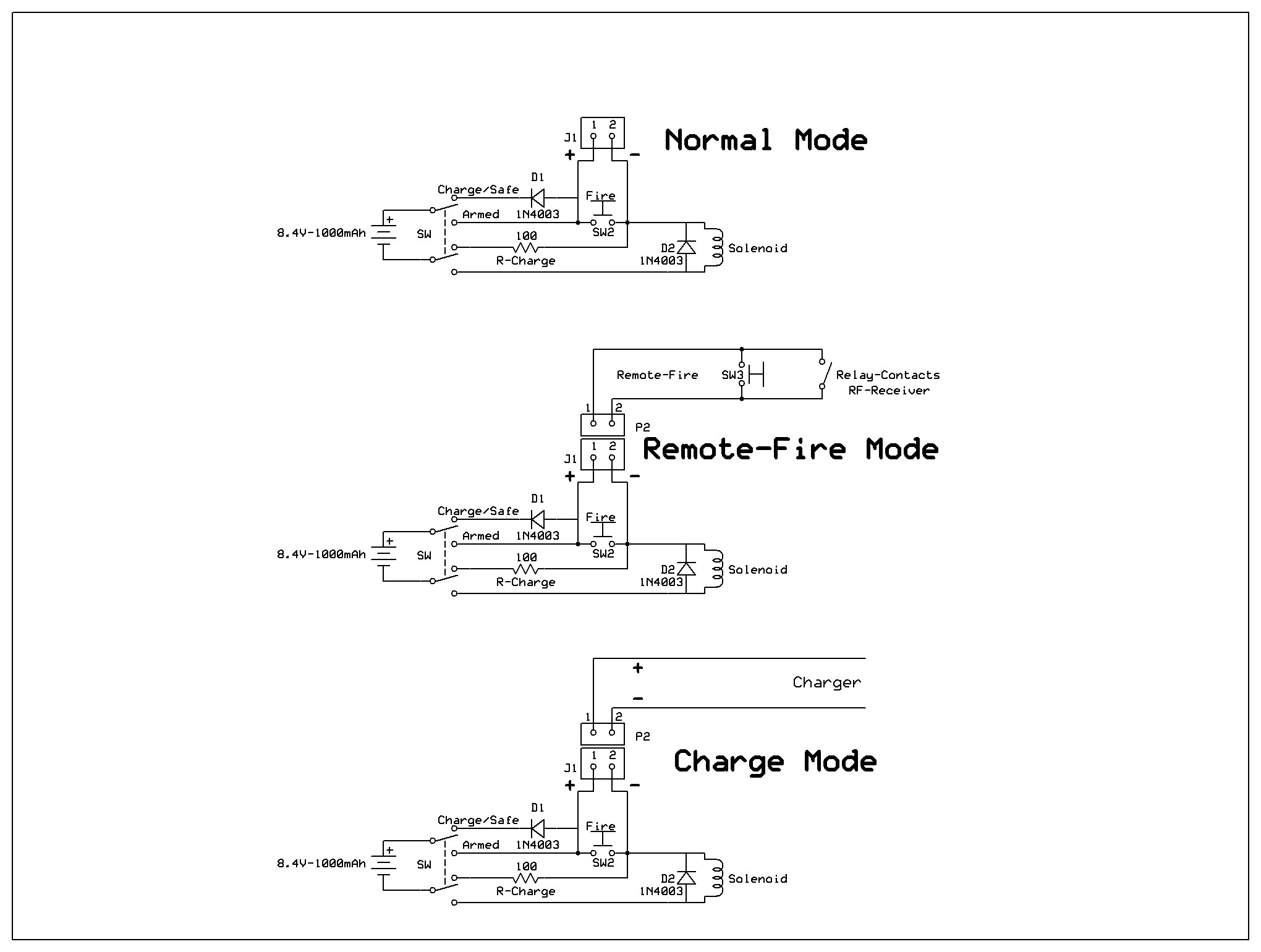

dewey-1
Posts: 1298
Location: NE Wisconsin USA
I have a circuit that will do what you want.
The Safe/Arm switch is DPDT that is not center off.
The "dual" switch allows total isolation between Charge and Arm circuitry.
D1 and R-Charge are used for the charging circuit.
The value of R-Charge is a 100 Ohm 1/2 Watt 5% and allows approximatly a current 50 mA if using a 12 VDC charger.
This will be about as simple as possible to do all your modes of operation.
Maybe Tech can review this to be sure I did not make any blatant errors.
Edit: Removed Jumper J2 in Normal mode, not needed. Schematic updated to reflect this change.

Your circuit will not have remote fire capability.
You need the remote fire switches in parallel like I have shown.
If you use my circuit you will have the functions you wanted.
The DPDT switch does not need a center off.
It has only an "Arm Mode" and "Safe/Charge Mode".

ah I finally completely understand it now. okay cool, so like in my picture above, if I plugged in the remote switch, I would have to have the rmeote switch turned on and the fire button pressed at the same time for it to work. while parallel is one or the other need to be turned on. Right?

David now you understand what I was getting at all along.
With the parallel setup you could have multiple remote "fire"switches like trip wire switches.
