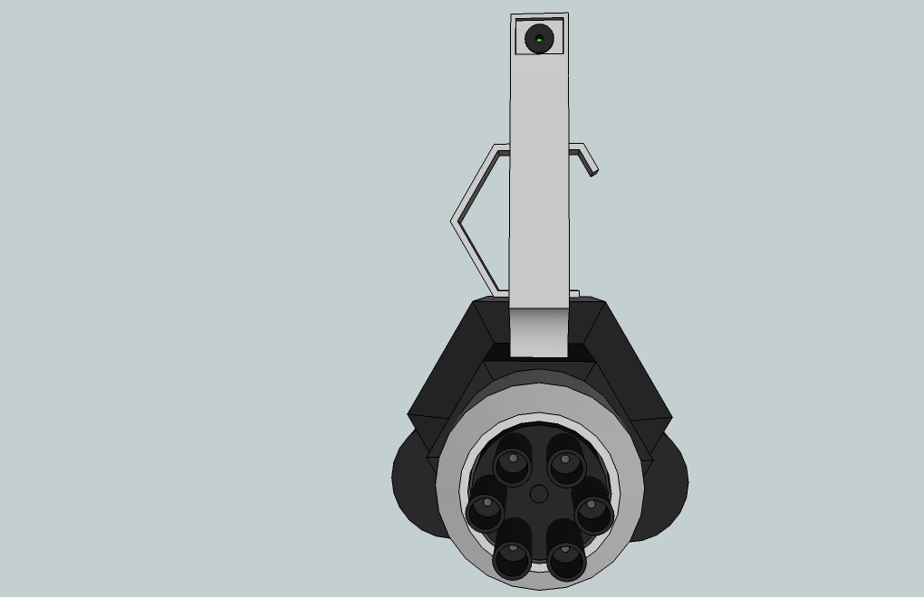

Been playing around in sketchup trying to get happy with the size and shape of things. It's missing a ton of detail and beveled edges, but you get the idea.
3VIL G3NIUS
Posts: 41
Joined: Wed May 25, 2011 2:35 am
Well I made the images look better in hope that someone will comment. haha
Still missing a ton of detail, but I am more concerned about getting the mechanism to work first, all the beauty can be done when it works.
I'll be adding a green laser sight like in the movie, unfortunately due to it's placement at the top of the pistol grip it will take quite a bit of adjustment to get right, and even then it would be off by a bit at distances. I'd probably work out some kind of scale so you can tune it based on the distance you are from the target.
I think I'll go for a vortex cap, not sure which angle I'll have the mag coming from, it really depends on whether I want the gun to fire out of the top or bottom barrel. I'd prefer the top as it would make the laser more accurate and be true to the real thing. I'll need a plunger to push the BBs uphill to the cap though, easy.
I'll probably use metal pipe and fittings to make only the seal between the barrels and vortex block the limiting factor. This seal would be several very well greased O-rings in strategic positions (I have to scan my sketch onto the computer) and hopefully work well too, although a very slight amount of leakage may be desirable.
Probably stick a NdFeB magnet detent in such a place as to hold approaching/waiting BBs in place until a barrel comes along.

It will certainly look good when finished, but you should sort out worky bits before worrying about aesthetics ;)

jackssmirkingrevenge wrote:It will certainly look good when finished, but you should sort out worky bits before worrying about aesthetics ;)
That's the bit I'm afraid of :shock:
I do have the mechanism drawn up, I don't have a scanner though so I can't get it onto the computer. Plus I kinda needed to design the shell first to know my size restrictions.
I'm not too sure where to start, probably with the vortex cap, mag, then barrel assembly. And then all the valve, HPA storage, drive and control stuff, then put it in the gun body.
Guess I better buy some pipe and aluminum rod stock and get to making it then!
Another few questions, what is the optimal size for a vortex cap ID? I was going to go for 1".
And why are you the only one who cares about this project? :P

3VIL G3NIUS wrote:And why are you the only one who cares about this project? :P
I don't, I'm just being polite ;)
The thing is that the vortex/cloud + spinning barrels gets suggested fairly regularly, you'll get much more attention by actually building it.
As to vortex cap diameter, 1" sounds about right.
Sort out an HPA source, make your chamber, fit your valve (a small DC solenoid valve should serve you well) and try it out with a single barrel - then move on to spinning barrels.
Hear, Hear!.....anyone with some sort of sketch program can draw a gun with a cool looking exterior. Sketch programs can even draw something that can't possibly be built by any technology known on earth. The the design, function and machinability of the guts largely influence the exterior appearance, design and size. Form follows function.
3VIL G3NIUSG wrote:guess I better buy some pipe and aluminum rod stock and get to making it then!
Might be a good idea to hold off on buying material until your design is 100% complete!
