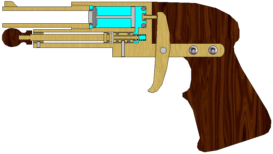

Been doodling some designs and seeking consultation as to what tools I would need to purchase exactly for my purposes and what is and isn't possbile with a lathe and mill. Here's one, not saying I'll build it but the list of potential projects is growing by the day...

selfcontainedminipistol, how do they work?
I don't completely get the piston.
Do you have looked for some reamers to use with your lathe? I drilled a hole yesterday on a lathe with a brand new 8 mm drill. It was pretty rough on the inside, too rough for pistons or O-rings.
Labtecpower wrote:selfcontainedminipistol, how do they work?
The dark grey part through the front is a rod so air is free to flow around it.
I still don't have a lathe :oops: what I do have is the money burning a hole in my pocket and the increasing knowledge that I need to be better informed before I part with my cash. My consultant assures me it will be fine in brass, though I have yet to see the full operation in action. Note that in this case the o-ring on the piston seals agains the breech, but there is no seal in contact with the chamber walls.

In the meantime, I noticed that the port between pump and chamber needs a hole that will then be plugged with a brass rod epoxied in place ;)

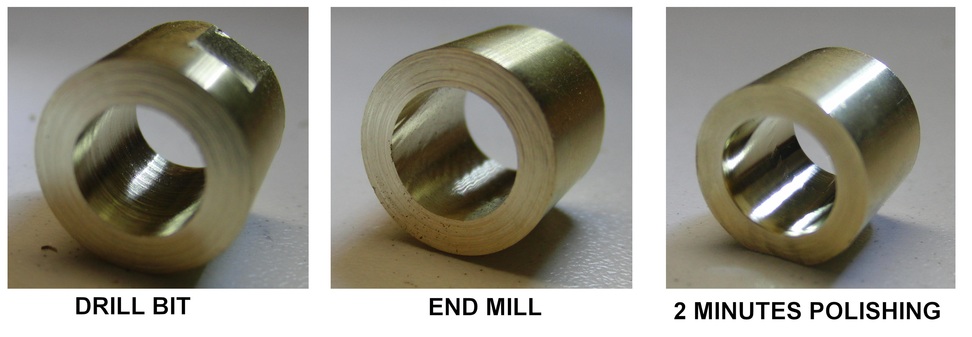

Here's for you 5/16" hole, just to feel it (very quick & dirty job)
But it is very true a reamer would do a better job... you never have enough tools ;-)
I HAZ A BANG!
Image Yeah, work it! Image
To be honest, even drill only looks good enough for piston purposes...
How did you polish?

No hammer and sear :(
No conical seat :(
No fold down grip for easier higher pressure pumping :(
No air inlet for the pump ;)
No spring to prevent air from leaking into the chamber instead of pilot volume :O
Actually that reminds me that some largish bore HPA pistol is something I've wanted to do for a while.
The pretty textures were meant to distract you!
Floating o-ring ;)
Pulling the trigger fully sufficiently blocks off the port ;)

Mmhmm and how does it get to the O-ring in the first place ? Loose fitting pump shaft ?
And the pin moves back with pressure on first pump stroke ?
