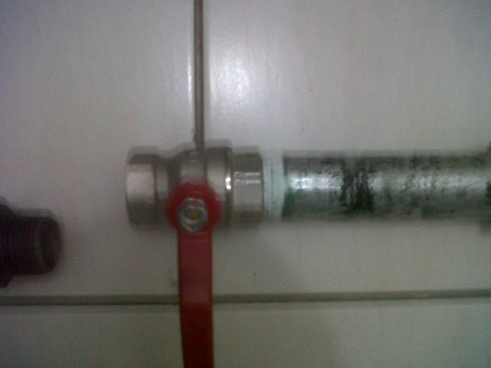

Unless the chamber is not in the photo, that chamber and valve are not 2 inch.
What size is the valve? Either that or you have some very large floor tiles.
The high mass of the projectile is very forgiving for the slow valve opening time. The graph is showing at that pressure the acceleration is not very limited by the valve after about 1.5ms which is impressive for a ball valve.

LoL ...ma floor tiles are 24" x 12"...and my opening time is less than 0.5 seconds with my lubricated spring action trigger! And the can are both of same material which is not thin aliminum like pepsi cans!

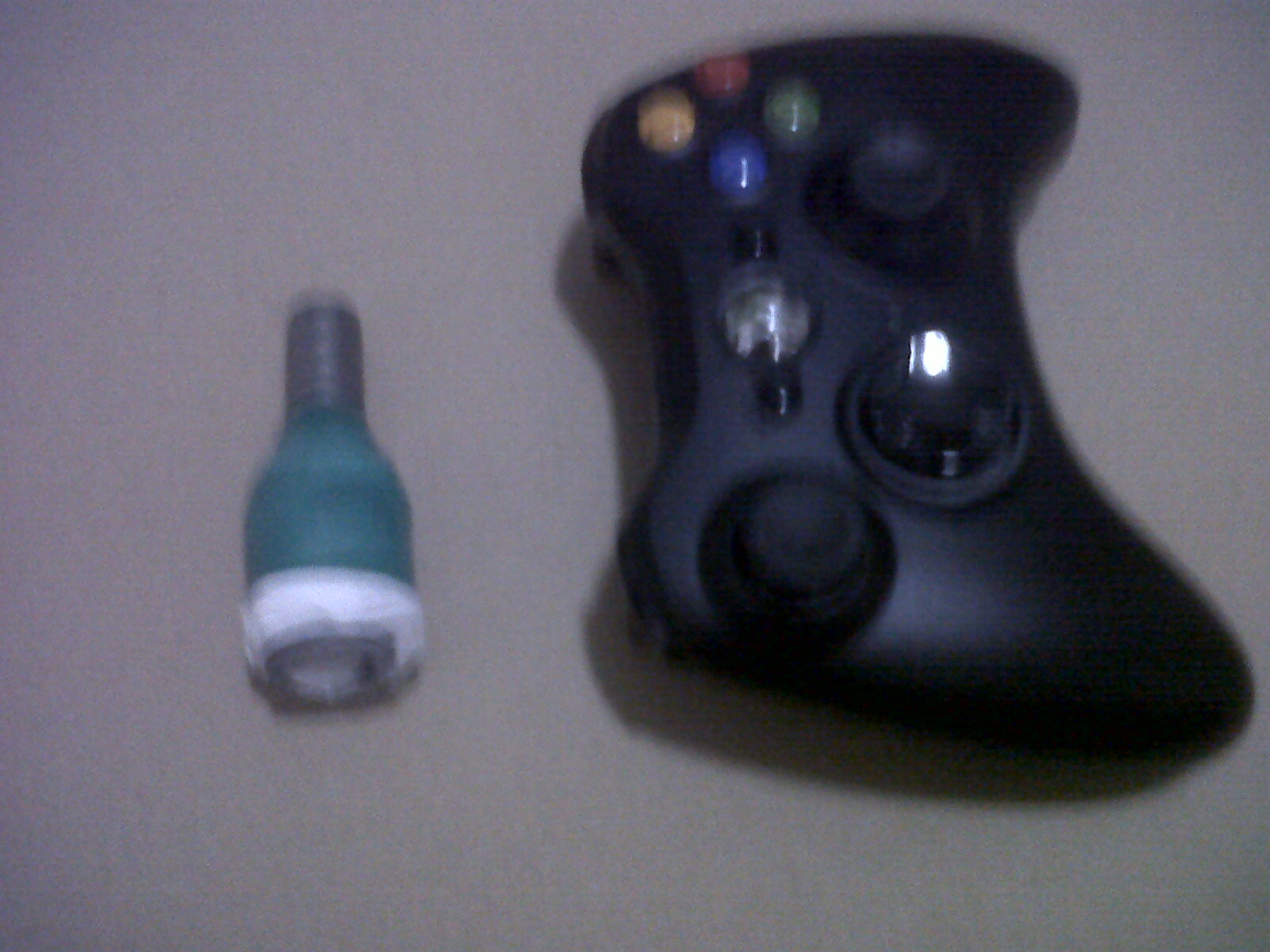

Wow,those floor tiles are VERY SQUARE for 24''x12'', also, by size comparison to the xbox controller, you projectile, barrel, valve and chamber are 1''
a 2'' brass ball valve would be impossible, even if lubed, to open in 0.5 seconds by hand....Please post a photo of the Xbox controller next to the valve.... it will help clear up the confusion.

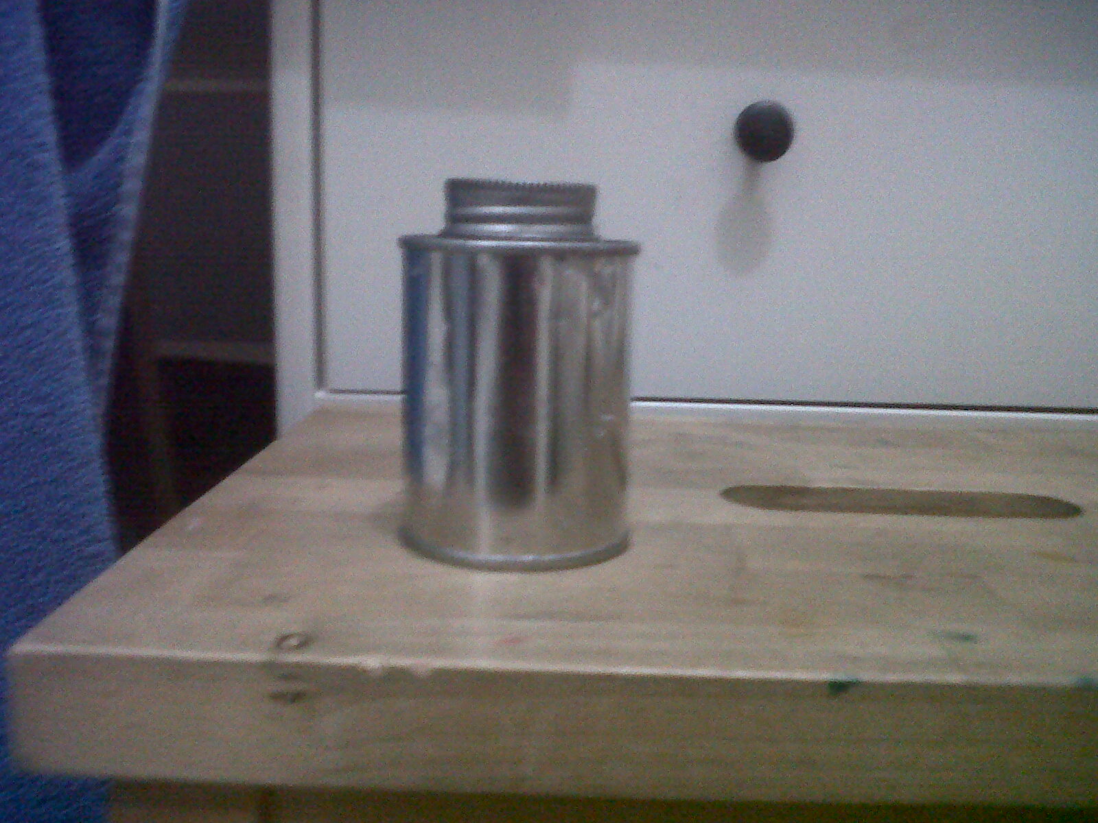

ALSO: that first can you posted... is a PVC primer can. something most of us on spudfiles know better than our own reflection.... and that IS very thin aluminum.
(The title of your image of the valve, says 1''... making your chamber also, 1'')

Ok since every1 is so confused ill post up a video explaining everything and comparing all the sizes and the damage shots will be included!!!!! Hope that will clear the doubts!!!!
For Now Here Is A Size Comparison:

And ur right tht is a pvc primer/glue can frm ace hardware(thin but not as thin as pepsi cans)!

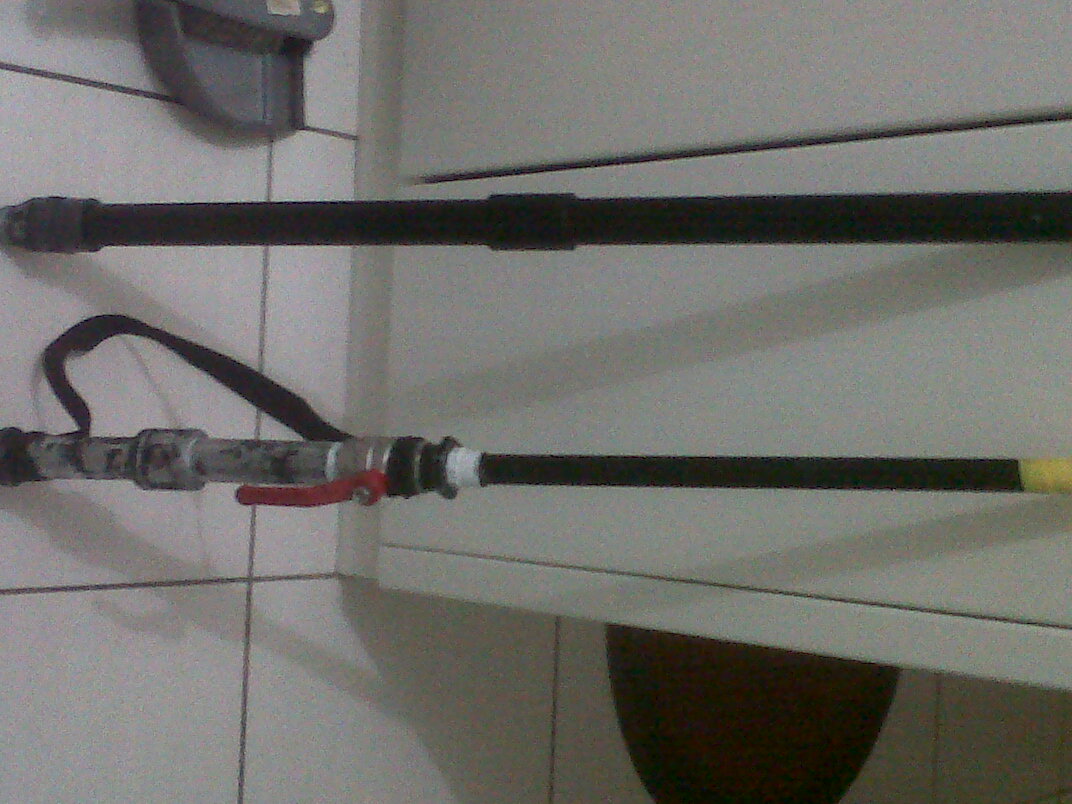

Can you kindly provide a photo of the complete launcher with the 1 inch valve and 2 inch chamber all in one shot? Without it I tend to believe the launcher is vaporware. The only complete real launcher we have seen so far has a 1 inch chamber with a 1 inch valve. It is in the photo labeled
My High Pressure Air Gun With A Sling
The primer can is the undamaged can. What can is the damaged can?
Then the photo showed the valve and chamber are the same size. Nice try on the most recent photo. A quick change from Galvanized water pipe to Black Iron pipe without a reducer or valve is noted.My 1 Inch Ball Valve As Trigger
I have personally found soup cans to be thinner than primer cans, though not as thin as Pepsi cans. I can open Pepsi cans by hitting one with a marshmallow. I have video showing it. Opening a soup can with a bolt is not that impressive.And ur right tht is a pvc primer/glue can frm ace hardware(thin but not as thin as pepsi cans)!

Is it too much to ask for a photo of the 2 inch chamber, the 1 inch valve, and barrel all in one photograph?
Example photo below.
What is the scale picture showing?
Nothing in there is recognisable from the first.
