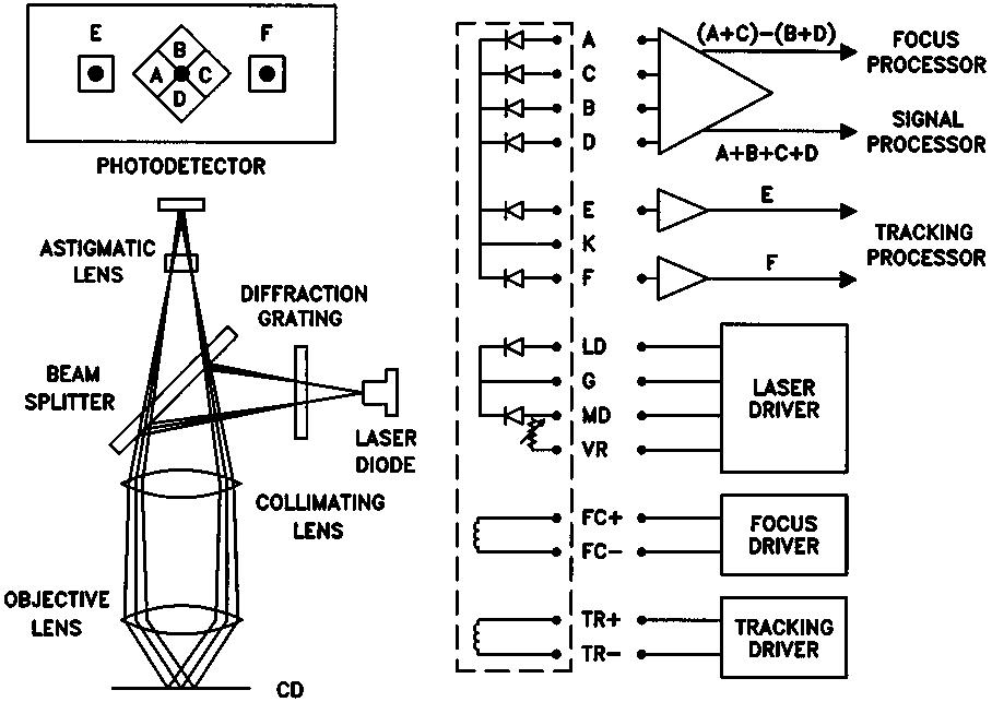

I would be most appreciative of a wisdom dispersal; that said my soldering skills and ESD/SMD capabilty are roughly equivalent to http://en.wikipedia.org/wiki/File:Homer ... Abbans.JPGTechnician1002 wrote:If you are interested, I can explain what all 6 diodes are used for in a CD player.
The four spots in the center are the main pickup and focus servo. The pairs cross corner from each other are mixed together. A cylinderical lens will make a round spot oval in one directon if focused too close and too far the other direction. The two pairs are compaired to provide the focus error signal and drive the lens focus coil to servo drive it into focus.evilvet wrote:I would be most appreciative of a wisdom dispersal; that said my soldering skills and ESD/SMD capabilty are roughly equivalent to http://en.wikipedia.org/wiki/File:Homer ... Abbans.JPGTechnician1002 wrote:If you are interested, I can explain what all 6 diodes are used for in a CD player.
