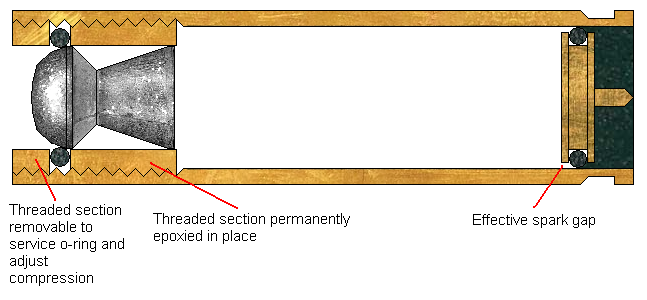

POLAND_SPUD approves of the designI'm giving this valveless design a go
wouldn't you need a notch on each of teh disks to screw them in ?
though I guess you realize that
- Has thanked: 581 times
The longer one will be permanently epoxied in place, I'll cut... nay, mill a notch in the shorter one to fit a screwdriver

Updated the diagram to reflect actual construction:

did you use the lathe to roughen up the epoxied part?
NaturallyCrna Legija wrote:did you use the lathe to roughen up the epoxied part?
I'm not convinced it's going to hold pressure because of the way the o-ring is supported, it might need a more sophisticated mount. We'll see, testing later today.

I'd be more worried about keeping the pellet in place rather than leakageit might need a more sophisticated mount
test this one and if it won't work you might add two mounts - one for o-ring that keeps seals and one for a washer (or some o-ring made of harder material) to keep the pellet from popping
As mentioned elsewhere, I doubt it will be an issue.POLAND_SPUD wrote:I'd be more worried about keeping the pellet in place rather than leakage

Just as I feared, I was unable to get it to seal. I tried boring it out to 6mm from the original 5.5mm and use it with an airsoft BB but to no avail.
This needs some more thought, and maybe a change of attitude towards design.
