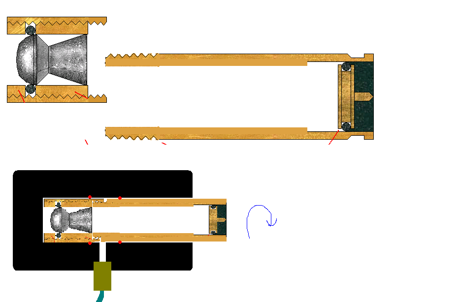

Have you considered creating a screw in plug for the cartridge ? either the pellet holder or the back of the cartridge could be screwed in in place after filling the cartridge
ohh something like this
the cartridge placed in a filling station

I see what you mean, but now you've added another seal between the two cartridge halves.
I like the idea of simplifying the structure though:
o-rings are quite cheap you know
and that solves all the problems that adding a shrader valve won't solve

I drilled out the back of the cartridge and added a simple check valve in order to try it out as a "conventional" burst disk cartridge. Epoxy curing, testing this evening hopefully.
A pneumatic cartridge ?? you diagram suggests that there is a metal insert in the epoxy plug so...
Posts: 26220
Been thanked: 352 times
POLAND_SPUD wrote:A pneumatic cartridge ?? you diagram suggests that there is a metal insert in the epoxy plug so...
Still a hybrid, the intention is to use the fill rig and have the igniter contacts with the valve and cartridge body.
Edit: spark gap works well, now to see if it seals. Watch this space :)

In other news, tried out the modded cartridge with air at 75psi, held pressure beautifully :) The epoxy bulged out a little though, indicating it's not cured yet so I put it aside. Still, looks promising.

Update after some frustrating testing, tried it at 6x - it held the pressure well enough, but the spark was arcing externally, clearly the spark gap inside was not small enough. It needs to be put together with more precision.

Did you consider machining the plug in some gluable plastic (Delrin?) or simply use a plastic sleeve and a rubber washer to insulate the central part?
I had started to make an acrylic plug but it shattered when I was trying to thread it... got some teflon rod cutoffs from work today, but they have a 10mm hole through the centre... but yes, when I source some suitable material, it will be a perfect idea.
Since we like making graphic tutorials, my turn ;) the valve stem could be shortened, but then you would also have to suitably insulate the end of the electrode which goes in to make contact with it.

So what's to stop you from insulating the valve stem? Or using a plastic one?

Oh! I see... I didn't catch the pressure had an influence... of course it makes sense...
Alright, here's a better insulated-no thread-no glued-self sealing one :D
