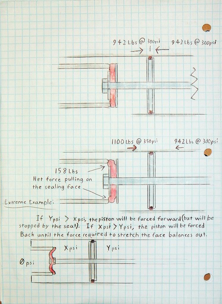

I did some brainstorming and I think I figured out your low opening pressure problem. Ok, I guarantee I figured it out*
First I'd like to direct your attention to an old high-speed video by clide:
http://gbcannon.com/projects/flipbooks/clearvalve.html
As you can see, when a sealing face is not secured to the rest of the piston completely, the face and piston will not move together in a uniform way. It will move long before the valve actually "opens", which in your case will cause it to dump the pilot volume.
Below is a quick approximation of your valve and what it will most likely do upon firing. There are a couple solutions to this, but the easiest is just to glue the face down.
*Guarantee covers both your entire purchase price and eternal salvation.

Unfortunately, my sealing face is epoxied to the washer behind it and I just went up to the garage to double check the epoxy hasn't come unstuck. The sealing face is quite secure and except for a chunk of epoxy 2mm x 2mm that has been removed, the epoxy isn't cracked.
Interesting solution though, not one I would've thought of.

Ok, that should mostly rule out the flexing issues, but it still could be the seal on the pilot instead. You may eventually want to replace your current pilot with a QDV-ish design. A couple washers, orings and a short length of copper pipe with porting holes drilled in the side would work fine.

Even if there was a problem with the sealing face, I can't think of why that would open the valve.
