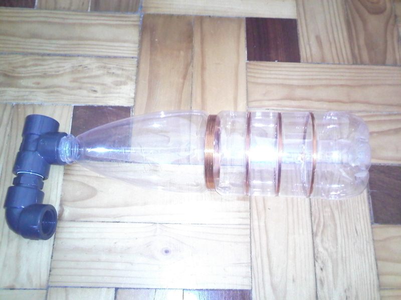

I had reinforced a bottle with cupper wires and epoxy, but I used it for a clear combustion :)

The bottle I made
The bottle I made
