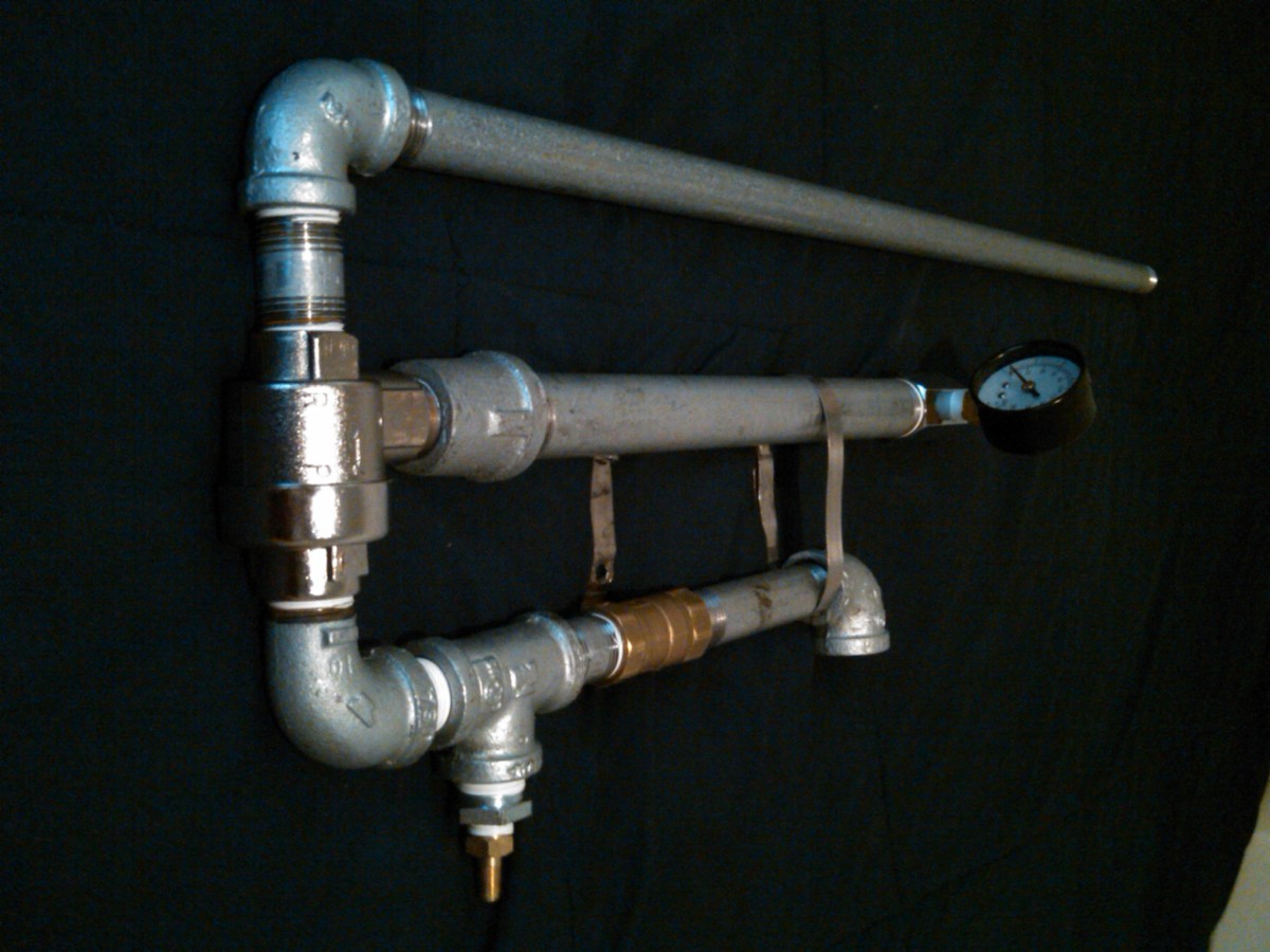

I made my first airgun but made the mistake of not actually researching first, otherwise I would have built with a QEV and proper size and proper rated chamber and fitting, etc.
But just wanted to show a funny rigged up trigger I made of random stuff I had laying around in the shed.
Also, is it possible to fill from the chamber side with a (store bought) QEV? or is there a check valve between the pilot and chamber that prevents this from working?
Thanks

Think there will be a big increase with QEV over my springed valve? How about if I add another pipe 90 (in addition to the bend of the QEV)?
far_cry
Posts: 317
sco77 wrote:Think there will be a big increase with QEV over my springed valve? How about if I add another pipe 90 (in addition to the bend of the QEV)?
they will be increase of power if you use QEV,but not very large because the BV give you great flow instead of fast opening !!
and i am afraid i didn't understand you ,what you meant ?

Made a test fire just over 12 bar with an AA battery... Do you think a QEV would perform significantly better with a shot like that?
Also kind of funny the battery hit the "Y" of a down tree branch behind it and split the tree branch in half, found the battery inside the branch split.
sco77 wrote:But just wanted to show a funny rigged up trigger I made of random stuff I had laying around in the shed.
Quirky but it works, I like :)
A QEV piston/diaphragm is usually cup shaped, meaning it acts as a check valve:
In order to fill from the chamber valve, you have to make a small hole in the piston, and add a spring behind it in the pilot area.

Redesigned it some after my QEV came... still have all the same crappy fittings because I didn't want to have to buy all new parts, but this gun is going to only be used upto 200~ PSI.
I bored the inside of the steel barrel smooth, I kind of like it better than copper besides the weight..

Try reducing the pilot volume, it will be better.
How exactly are you piloting, is that brass bit a ball valve?
If you, you should connect that to the elblow, and the fill valve further down the line.
sco77
Posts: 34
Joined: Thu Jul 14, 2011 3:54 pm
Gun Freak wrote:Try reducing the pilot volume, it will be better.
I would but I don't want it to be overly sensitive to schrader valve (would have to add in another valve or check valve?)

I suggest getting some seamless pipe for a barrel.
