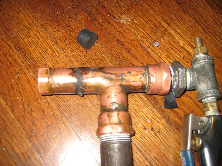

This is my newest finished project. The chamber is 3/4''x12'' steel pipe running through a Tee into the copper valve. The piston is hot glue with a 1/4'' thick slice of a rubber stopper as the sealing face. The barrel side of the valve is appox. 1/2'' porting through a 3/4''x1/2'' fitting adapter and into a 1/2'' threaded adapter. I may change the chamber setup with a three-way valve to use with my co2 tank and maybe a regulator. It seems to pack a monster of a punch but i have yet to test it above 80PSI.

Not bad :wink:
I've always found that Hot-Glue pistons were not really suitable for piston valves....
especially with certain lubricants which sort of degraded the glue and became all sticky.

Thanks! White Lithium Grease is what I used so I don't know how it will react. It seems to be doing fairly well but I'll keep an eye on it. I actually made three different pistons trying to get it right. Finally did it though. Next buy is a three-way -valve-(edit) and a HPA tank. Semi-auto! :twisted:
