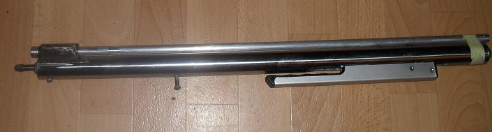

more progress.
Made a breechplug thingy like on a crossman pistol..
Fixed the weld, now it's a solid chunk of metal..
I took a picture of the pressure test set up.
Still...40 pumps I get 16 bar...hmm..
Oh well...100 pumps it is.
It's still selfcontained.
I am seriously thinking about building a CO2 12 gram version pistol using the same valve...I imagine a revolving cilinder around the pressuretube... :D
That would have some amazing power!
I found out now that the welds are no longer leaky...that when I depress the valve it stays open!
When I pull it closed it slides back in...
When I release the pressure, it closes!
Yeah!!
This means it stays open until the barrel is empty!!
Maximum power and minimum waste!!
Okay...In theory...but still cool..
On with some pics:

And pretty poweful at only 40 pumps too:

but it requires way too many pumps... I think you need a longer stroke pump and an longer lever
Netherlands
Posts: 3497
After the first shot it requires less.
Like 10 or so.
The idea is to have big reservoir performance...
But indeed, longer stroke and longer lever would be better.
