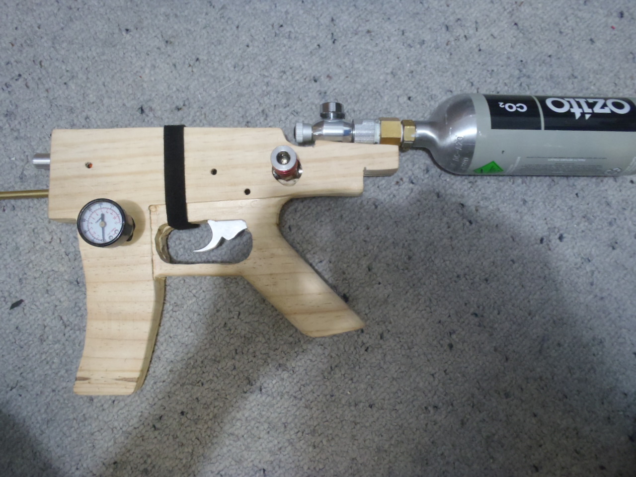

I'm an Aussie,from down under here showing off my first pneumatic.
Anarchy- the 6mm semi Auto particle accelerator.
QEV powered, Co2 regulated piloted by a 3port 2 way valve.
It is currently running on compressed air , my compressor can only go as high as 120 so my plastic ball bearings will only just go through paint cans.
will be run off CO2 eventually when i build a fill station for my many empty soda stream canisters. the breech is a machined block of Al with spring detente and is hopper fed. i have found so far the hopper method works quite well, the air flow agitates the balls.
not quite finished but is functioning really well, firing as fast as you can pull the trigger, i don't understand the need for full auto.

only cosmetic work will need to be done, iron sights(maybe reddot) and the barrel of the m16 needs to be made which i will incorporate a laser pointer and silencer.(bit loud for the wascally wabbits:P)
Any comments suggestions welcomed this is only my first gun and not finished yet, still needs a coat of gun metal grey:)

Welcome to spud files. Nice, much better than my first, Id suggest to try and hide the fittings in the stock , and a nice coat of paint.

i was going to hide the regulator but just kinda hard to machine a block of timber thats going to be easily accessible to the knob in front. should have bought a different reg. got a can of gun metal grey ready to go, couple more days work i think.. not sure how to add more pics to the first post to show the internals.

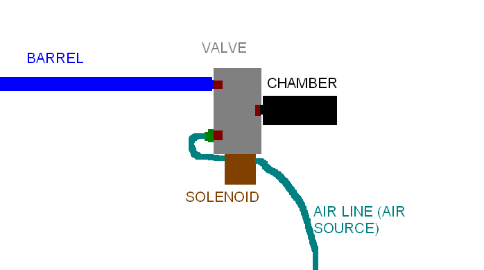

is the 3 way valve piloted ?? (i.e. is there a small valve on it that triggers the main spool on the valve?)
If it is you might consider testing the gun with the QEV removed, so that the 3 way becomes the MAIN VALVE itself
the performance will suffer (not sure by how much) but you'll get a much simpler gun, save space and reduce air consumption (let's face it - there is too much dead space between the 3 way valve and the QEV... and yeah I know it won't be easy to fix that)
Very nice, the barrel is a bit low and the sodastream bottle too high to allow a reasonable scope mounting, but that's my oft wrong opinion.
Considering the size (and correlating strength) of the barrel, a full shroud silencer would be the way to go, it'll protect the barrel from damage too.

um as for diagrams im not the best at drawing , but the 2way valve is set in the off/pilot position so it actually discharges when the trigger is released rather then pulled. got it off ebay so didnt get a good look at the pneumatic symbol on the valve.the valve itself actually has 3 ports the pilot port is hidden behind the hopper with just a small gap to vent internally, i didnt port through the case itself didnt figure that the internal of the gun would reach high enough pressure.
@POLAND_SPUD why would i need to remove the QEV? i thought that the valve would function faster then the 2 way would? and you are right about the pilot volume, there are 2 extenders between the valves wasted air.
@ zeus, completly agree but that comes down to the co2 regulator design i needed to keep the tank parallel and out of the way of trigger.oh and PMed

yes, it probably functions faster with the qev than without itwhy would i need to remove the QEV? i thought that the valve would function faster
What I am saying is that you can build a functional gun without a QEV if you use a 3 way valve as the main valve. In some cases it might make sense to sacrifice performance for space and mass savings.

Ah so thats what you meant, i saw that pic around the place somewhere. that actually looks quite cool i plan to make a small co2 gun that runs of the 12g canisters so i might go with that design, unsure what pressure the DCV could handle as i would go un regged co2.

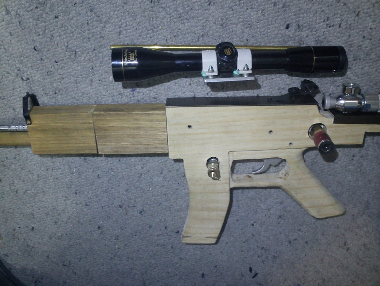

+++Update++++
So iv been working in the shed quite a bit and this is what i have come up with so far, still more cosmetics to come but i thought i would stick this up for all my followers lying in wait.
took a circular saw to the thing and squared it up nicley to add the sight rail. sanded smoothed the body, added a rail to square the reg support that was poorly machined.
drilled out the 2 blocks of wood barrel as a support and housing for the Al hopper plug and will continue the dowel barrel another section.
they are that long because i dont have an extended drillbit and lathe restrictions. the iron sights i picked up for a huge bargain , 5 bucks from a guy selling crossbows at my local market.
the front block above the barrel has a laser mounted inside, more needs to be done to that for adjustments but its functional now. the rifle scope is X8 too strong for bb's unfortunately.
not sure what else to say really, happy with it so far but kinda want it done so i can have my life back, think i have spud fever :S(have a combustion too)
The idea of dismantlement has appealed to me to keep it in 3 pieces the barrel body and stock/bottle. I am currently looking to obtain a class E Co2 canister to act as a fill station, with the intention of running around 150 psi or so i dont think ill want to push the valves too much and im worrying about anti syphon for a tank lying on its side that has no anti valve.
whats left to finish? barrel, laser adjustment, reduce dead pilot space by adding Al rod drilled out and push-fit silencer then ill glue it all together sand undercoat and gun metal grey:)
any suggestions for detailing, rifling or on building a fillstation welcomed and encouraged. @poland spud, sorry meant that i intended to use a bicycle co2 inflater(12g) that is actually flow regulated, thanks heaps for the info i do have 1k steel bbs but waiting on co2 for damage pics.
