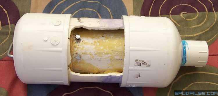

This is my first cannon. It's a 4x12" Sch40-PW PVC chamber, 4x2" ABS reducer, short section of 2" Sch40-PW PVC, 2" Sch40-42 female threaded adapter, a 4" Sch40-PW female adapter and a 4" Sch40-PW (yes, pressure rated) clean out plug. Of course I can't forget the shell made of 6" Sch40-PW pipe and end caps. After I had glued together the initial chamber I found out from Spudtech forum members that even thought I used transition glue the reducer has a high probability of separating from the chamber. So I built the shell. I machined the end plugs to have nice holes in them and proceeded to glue the shell together with the chamber. I then filled it with expanding foam in hopes of containing chamber failure. I later had to cut the huge gaping hole you see because of a design fault. 2 disposable cameras through an ignition coil had sufficient voltage to jump through wire insulation and 1" of foam, but I suspect a bubble formed around the wires leaving only some kind of gas between them. So I cut out the hole with the intent of building an ignition system into it and placing a piece of Lexan over the hole. Before this happened I decided I wanted multiple sparks, a stun gun and propane ignition, so I proceeded to build STAG2.

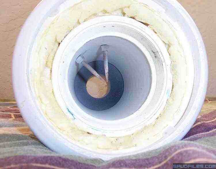

This is a shot inside of the STAG1 chamber. You can see the expanding foam between the chamber and the chamber shell. Also not the ABS reducer and the rusting sharpened electrodes.

i like the idea of the expandable foam. seems safer.

i still dont get why you cut a hole in the side

oooo i like the fail-safe design with the expanding faom....very good i might build something like it.....maybe...i know my parents would like it

i like the idea of extra safety and everything but honestly it seems like a bunch off extra work that would make this harder to adjust and change to your cannon later on. as long as your useing sch40pvc i wouldnt say its all that necisary unless your useing something like nitrocellulous for fuel...
