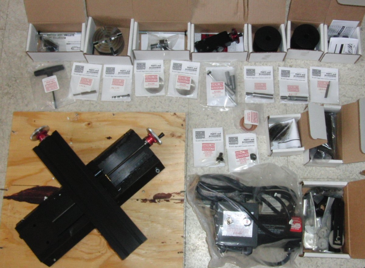

I think I should hide my credit card, work with what I have for a couple of weeks at least, then see what I really need and what I will probably forget in a drawer.If you didn't bought anything else while I was not looking, you have a 1/4" square holder for the lathe. And 3/8" round for your mill (3/8" end mill holder and 3/8" max on the drill chuck).
Bought lots more brass in the meantime, expect cartridges of some description in the next few days
Send it to me. I'll use it when you need itI think I should hide my credit card
Very good! Make that a couple of month, and try to buy as much as possible in a single shot, you'll save a lot of shipping charges. Take the time to go through a whole machinist catalog, like KBCTools. You'll know what exist, what is cheap or not, what you can fit on your equipment and what additional tool holder you will need. And it's fun toowork with what I have for a couple of weeks at least,
This <s>never</s> rarely happened to me.what I will probably forget in a drawer
Goodie!expect cartridges of some description in the next few days

Sound advice. I predict that before the year is through I would have purchased a separate motor and table for the mill...Very good! Make that a couple of month, and try to buy as much as possible in a single shot, you'll save a lot of shipping charges. Take the time to go through a whole machinist catalog, like KBCTools. You'll know what exist, what is cheap or not, what you can fit on your equipment and what additional tool holder you will need. And it's fun too
Very good!
But some important accessories are missing... I'll make a list...
... and quite an accurate prediction.I predict that before the year is through I would have purchased a separate motor and table for the mill...

but not the $%^&%^&%$#@^$&%^$#@#@ mill column attachment screws!

edit: cheers to LeMaudit who kindly chipped in with the missing bolts, common enough items but impossible to find in a metric locality, hopefully I will be able to set it up soon.
