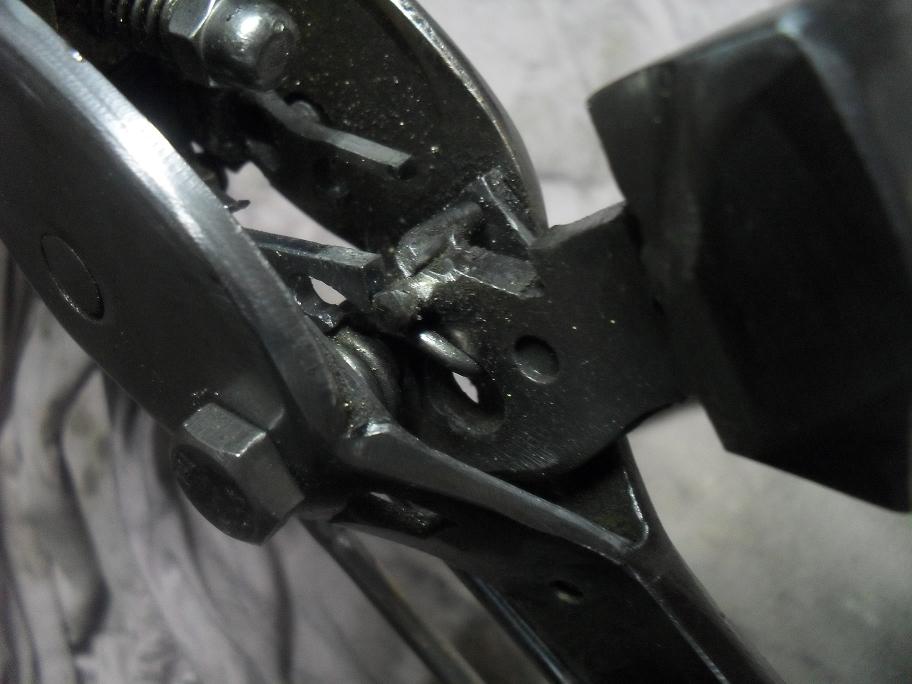

I made the halfcock safety notch.
This is basically a notch in the trigger about halfway into wich the hammer locks in such a way the trigger can not be pulled.
This disables the trigger and keeps the hammer locked in position so it can't push the valvestem
After the vid I discovered the hammer axle had turned loose a bit, wich effects the spring.I need to put a nut on the other side.

Normal cocked position.When rear of trigger rotates up the hammer can swing forward.
halfcock safety.Because of the shape of the notch the trigger can't rotate up.Only fully cocking the hammer frees the trigger.
