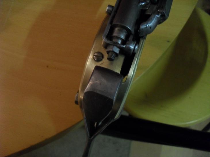

Netherlands
Posts: 3497
This hammer is the result of trial and error.
I welded on two stubs for the mechanism and a nut on the axle.
It works just like Skywalker said.
But...the result of all this -figuring it out as I go along- means the hammer is fairly ugly.
I plan to use this one to make a new one, now I know where everything goes.I hope to make a brass one from a single piece...
But that is just to make it look better.
I'll take my time to replace or fix every part that bothers me untill it looks pleasing to me.
I have shaped and reshaped the basically all of the springs ( leafspring too) untill it worked just the way I wanted.
The lever and hammer both need to go.
They are quite literally prototypes.
I am quite pleased with the locking mechanism on the lever though.
There is a spring between the lever and the cocking-rod.
This pushes the rod outwards as the lever is at " rest" as the brass nut ( first thing I focus on in the vid when I pull the lever) slides into a shallow part of the cockingrod.
It locks it in position.
A very simple, compact and almost invisible solution.
Too bad the vid doesn't show it working due to the bad lighting
I just checked the gun...I usually go out to smoke and end up in my workshop...and I could still cycle and fire the gun...3 times....I hadn't touched it since last night..while after the vid I had done one more shot...So I guess it seals up nicely!!
I had only given it 31 ( why 31?? :roll: ..don't know..) pumps.

First I'll go all out on this one and create some art!
Made the top cover..I'll do more work on it later so this is not the endproduct.I'll engrave it and sand some off the sides to make it follow the frame.
The soot trick worked.
Not exactly the shotgun in the vid but I managed to shape it quite well intill it could be fixed in place with a single screw.
It doesn't slide or tilt in any way.
Too bad I had rounded off the steel frame before...else I could have made that seam much smaller...
