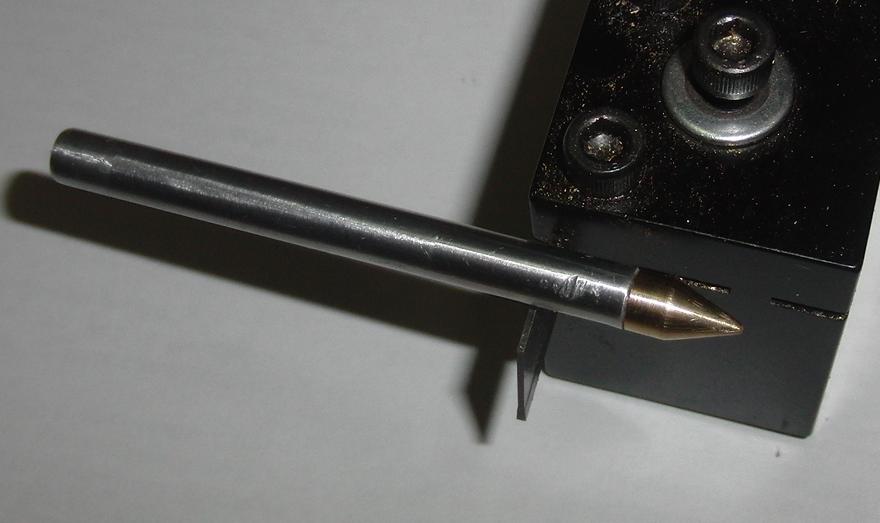

Update: made a quick brass nosecone mounted in a length of aluminium tube and the result is dramatically different, this time the projectile was clearly traveling dead straight.
Next step is to make a very light (hollowed out balsa wood to change the shape without changing the CG too much) conical tail section and see if I can get the same results.

Strange enough this thing flew pretty straight;
The holes it made in the plywood were perfectly round.

Had the same result with a can of energydrink.
If it travels fast enough it will not have the time to tumble over that kind of a distance.
This does not mean the projectile is stabilised during flight.
It does add to the discussion though.
Speed itself is an important factor in accuracy.
Great result JSR.
Although that really is a short arrow..not a " round" ...
Great result JSR.

What are the dimensions on that aluminium rod? How does the linear mass density compare to that of UHMWPE or Delrin? I think you'd want to continue trying to use plastics; I'm pretty sure aluminium rods (hollow or not) will get pricey...

That will reduce base drag (which will shift the CP forward) and add weight to the back (which will shift CG to the back) so it can f### things upconical tail section and see if I can get the same results
