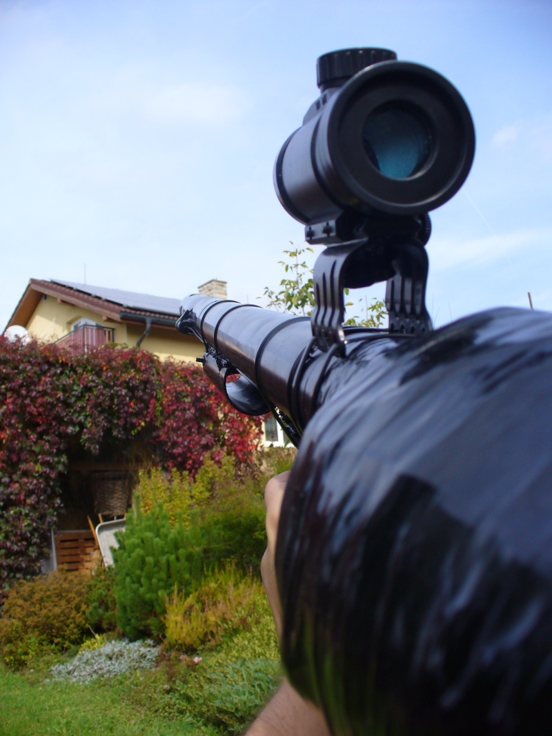

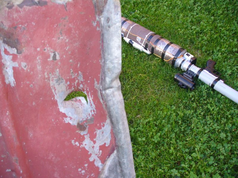

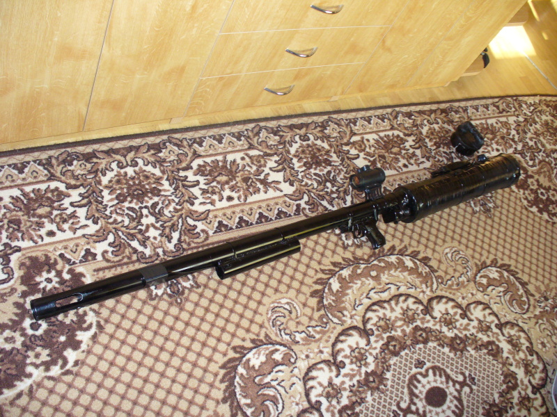

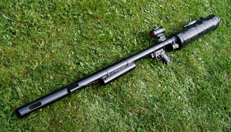

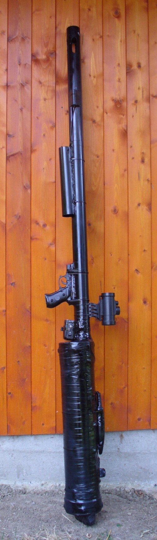

First of all, please apologize some grammatical and other errors, my English is not very good, I am from Czech Republic (small country in middle of Europe). I want show you my second Potato gun, what I made. On this gun I worked almost whole holidays of this summer and I think I succeeded quite 8).
Here are some features:
- weight: 2,3kg
- height: 170cm
- chamber volume: 4l
- barrel diameter: 5cm
- muzzle velocity: about 65m/s
- range: about 200-300m
- electronic trigger
- fan (runs on 18V)
- add laser and collimator (from old toy-gun and its mainly for effect, but functional)
- construction time: about 30hours
- price: about 800czk (its about 45usd)
My second Potato Gun
- Labtecpower

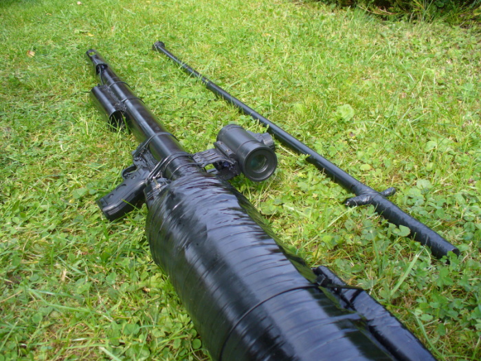

Looks pretty cool
I think it would have been better without the tape
how do you fuel it?
how do you fuel it?

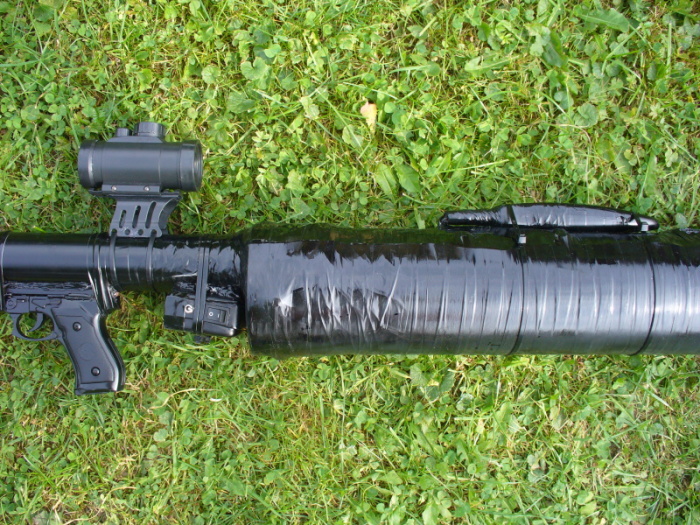

Thx, I had to used the tape on chamber, for covering a wires and other thingsLabtecpower wrote:Looks pretty cool![]()
I think it would have been better without the tape![]()
how do you fuel it?

Thats a pretty cool build. I think you may have used a little too much tape though, lol! I like how you incorporated the pistol onto it. Congrats!

The screws only weaken it.
Dunno why people always do that

I disagree, if you epoxy the screws when you put them in, there is no real loss of power or stability. However, I wouldnt do it on a pneumatic or a hybrid!!!Gun Freak wrote:The screws only weaken it.

Ok it probably won't blow up but what is the use of drilling holes in the chamber and plugging them with screws?
