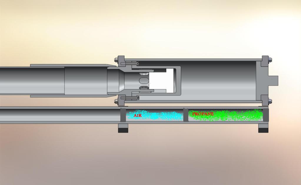

Just wanted to share the progress on the design.
Fill manifold coming out the back. Steel hex caps with aluminum plug style components to reduce weight while getting strong end caps for the studs to bolt against.

Is that a breech load on the barrel?
- Technician1002
- Posts: 5189
The design looks great. I do believe that is a breech loader.

I agree for sure. Its just that I don't want to drill any holes in this particular cannon's chamber as it reduces pressure rating. I'll see what I can do. Aesthetics is very important to me.Crna Legija wrote:It would be cooler if you put the air and fuel into the piped under the chamber, would make it real clean looking like all your other ones.

Any progress on this? Hadn't noticed it before but it's something I wish I had done with my 10X, perhaps a little different piston design, but still the same idea.
I agree that aesthetics are a good compliment to a good working design.
Also good call on getting rid of the inside wall butting - that would of been a bitch to do lol. If weight savings were your goal an external stepped wall would have accomplished the same thing with an oversized pipe to alleviate the loss in volume.
In your current design are you using tie rods to keep the caps on? I'm working on the design for my next gun and tie rods vs creative circumventive design was a big "aesthetic" question lol.

In the endless battle for weight vs power, I decided that tie rods were just the strongest and simplest way to do it. Threaded end caps might have worked, but the design gets complicated when trying to incorporate a piston housing on the front end. Steel end caps are used here however for strength.mobile chernobyl wrote:Any progress on this? Hadn't noticed it before but it's something I wish I had done with my 10X, perhaps a little different piston design, but still the same idea.
Also good call on getting rid of the inside wall butting - that would of been a [female doggy] to do lol. If weight savings were your goal an external stepped wall would have accomplished the same thing with an oversized pipe to alleviate the loss in volume.
Right now I am sitting back and reading new posts, rethinking some things and just paying attention to anything that might make the design better before I take the plunge. This has already paid off with the following example. Tech mentioned a way to remedy one of my biggest concerns in another thread regarding pilot air compression and heating in a non vented configuration. I am actually going to utilize that now by running a tube from the pilot to the main support structure and have additional pilot volume in that structure tube.
That tube was going to be used for propane metering, but not I can go manometric and use the tube for pilot volume. So, just by being patient and doing nothing, the cannon has already bene improved to at least a 2.0 version
I got itchy and almost bought material, but i'm glad I waited. Sorry for such a long post.
