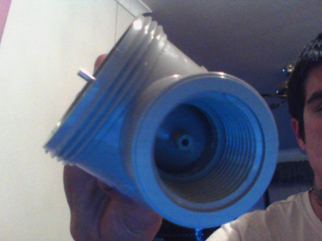

open it, clean all the parts and make sure they are all in place. any picture of the valve?

There is a very small hole in the output side of the valve. (barrel side)
Think about how a sprinkler valve works with a solenoid on it.
Where does the "pilot side" air/water get vented?
It has to go somewhere for the diaphragm to open.
Put epoxy in that small hole that goes to the barrel side.
This has been mentioned in the sprinkler valve modifications along with removing the filter that is mounted on the diaphragm.

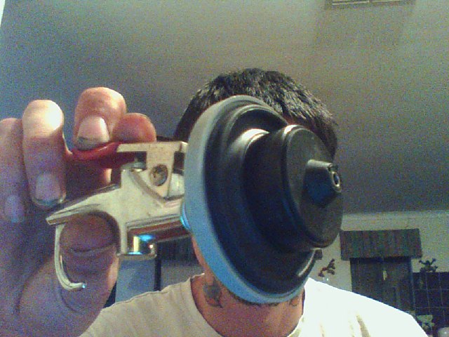

Can you post a picture of how the blowgun is installed into the jartop?
So you removed the solenoid and the bleed lever.
This may still leave the bleed hole/solenoid vent open.

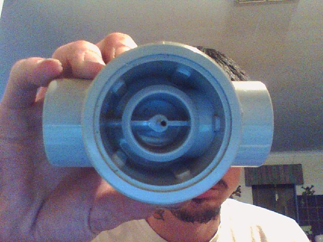

Which picture is the barrel side? I think it is the last picture due to the small hole/tube in the middle of the opening.

last pic ( Snapshot_20111026_4.JPG) i have it chamber side, though i did have it barrel side with same probs. i just putty up the bleed holes in Snapshot_20111026_2.JPG, going to see if it works....

There are typically arrows molded into the sprinkler valve body that indicate the the direction of flow.
Make sure you have it installed so the barrel is the output side.

okay, i flip Snapshot_20111026_4.JPG to barrel end and seal the "bleed" holes in the lid and it holds about 130 psi.....fixed :D now no quick busts when squeeze the trigger, air just comes out real slow, its not blocked, should i drill out the hole bigger?

This is the vent that need to be blocked not the other end.
