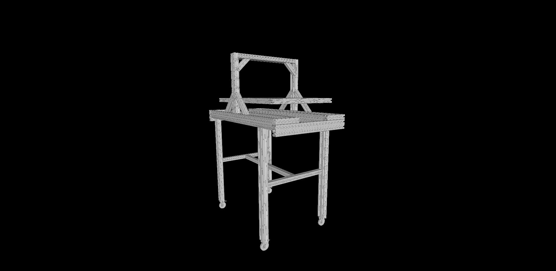

Basic system design

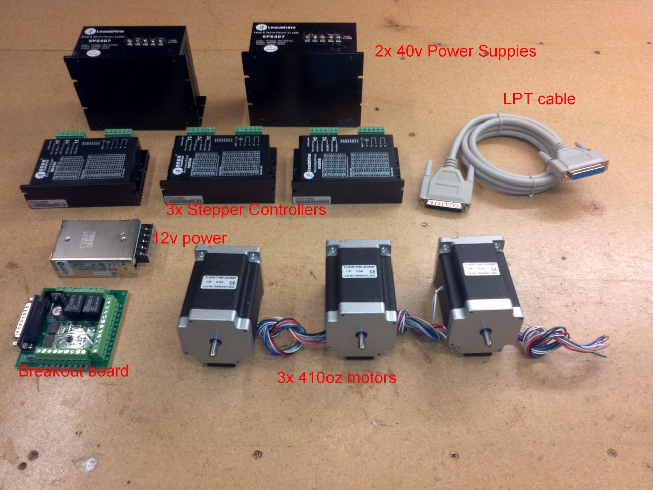

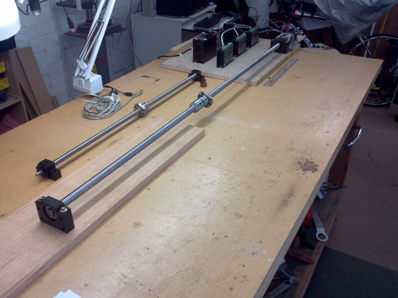

Electronics bundle & the x/y lead screws
Sorry for the crappy image of the table design but CAD to JPG does not work too well for me.
The design is a moving table / fixed gantry. Initially I will use a standard 1/2Hp router as my cutter but will move up from there.
As to online plans, I cannot go past CNCzone. Have a look at the sections on DIY builds, particularly the JGRO concept. It is all about creating a CNC router but if you are talking about HDPE or non-ferrous then it is basically a mill by another name.
Please feel free to PM me if you want to talk about this in more detail or if the other members don't mind CNC chat in the spud forum i am happy to update this thread from time to time on progress.
Cheers
