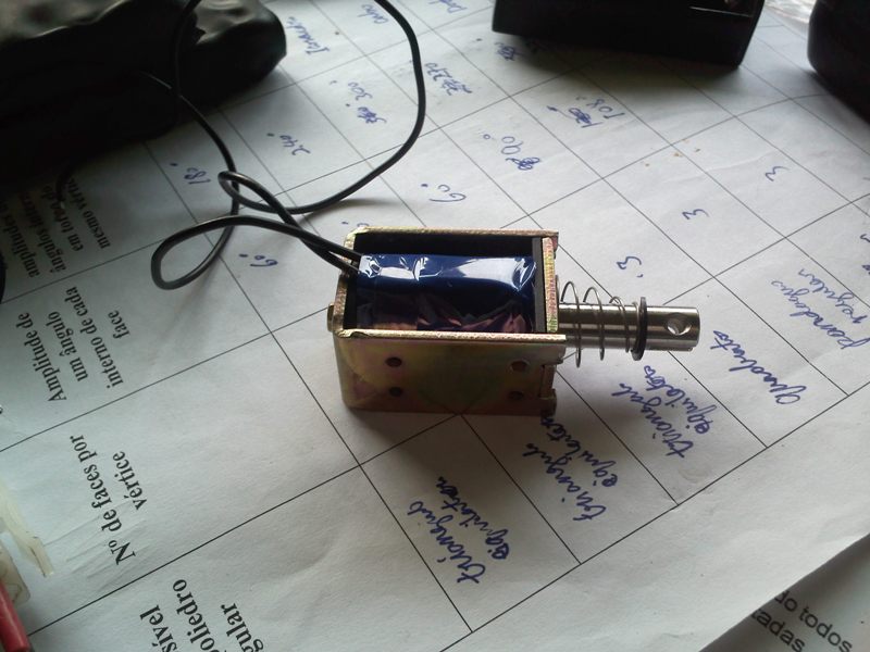

Hi everybody.
During last two weeks I have been testing and adjusting the solenoid+valve system. It wasn't reliable at all, sometime open sometimes doesn't. Apparently jack was right about the hammer issue, the solenoid has a great holding power when fully opened, almost enough to activate a blowgun. But if I put little weight on it before it's activated, it won't move. After checking the black bird airgun valve, looks like that valve needs much less travel space to open. So I actually only need the valve to block the feeding of bb from the magazine, half of the bb's diameter will be enough to do that. I will make the valve more sensitive to the solenoid, probably only 0.4 cm to open, but if somebody have constructive opinion, feel free to share. I will post some picture about the solenoid.
Btw dewey-1, the solenoid's resistance it's 15.5 ohm

Is this how the solenoid is actuation the hammer valve?
wyz2285
Austria
Posts: 2390
Location: Porto, Portugal
Well yes that's my basic idea, but the finished system will be quite different, as I will change the valve, also adding weight on the solenoid.

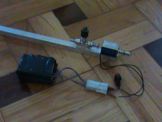

Oh btw for who wants a demo video, I will show it this weekend. As I haven't find a right size spring, the valve is only able of one shot.

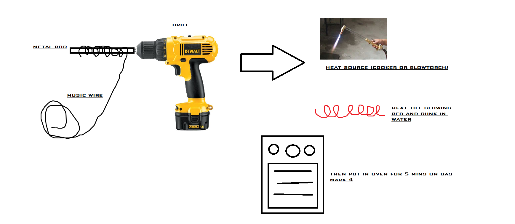

Goats spudz
Posts: 458
Joined: Tue Aug 02, 2011 12:31 pm
make your own spring!
Where's my Chuck key?
wyz2285
Austria
Posts: 2390
I´m making my own spring, but it´s really difficult to find the right wire and shape it right too. The solenoid doesn´t left any tolerance for mistakes :wink:
Goats spudz
Posts: 458
guitar string wire and a drill to spool it on and harden and temper it :P
spring making :P
spring making :P
wyz2285
Austria
Posts: 2390
Didn't know this way of making a spring :p looks simple and as almost all my friends play guitar I should find a nice string. So after the heating process it stays in a definitive spring shape? What's the temperature needed for that?
Got a spring now, a picture of the prototype. As soon as the epoxy cures, I will up load a video.
