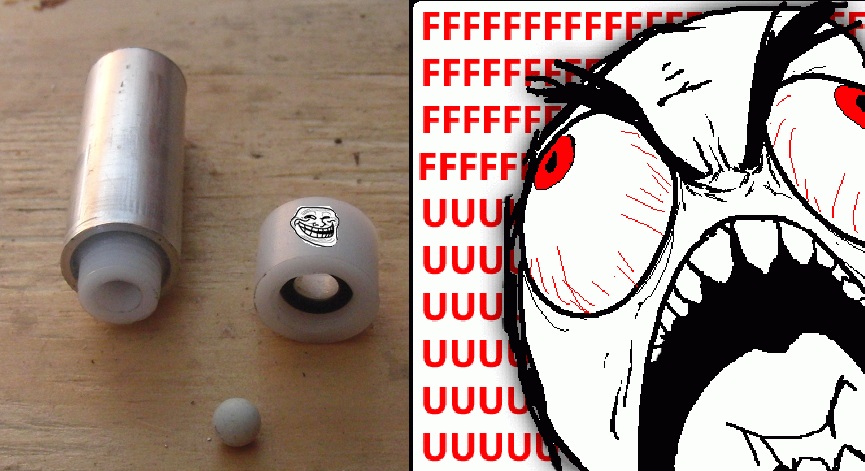

Some progress, and possibly the smallest hybrid shot ever:
This is the only shot I managed, fuelling is extremely fiddly. However, the o-ring detent setup held in a threaded fitting worked perfectly in terms of "valveless" filling and firing, and since it was made out of delrin cutting the threads was no big deal.
In this regard, I'm going to scale it up to 0.22", watch this space
Here's the setup, I machined a PVC inlet for the fill rig in order to reduce dead (non cartridge) volume and make it easier to force the projectile to seal against the detent:

Wow, that is tiny. Cool, what is this like your 50th hybrid or so, lol
Hang on, I'm confused. maybe its because its 0127 in the morning, but bear with me. The whole idea with the pin inserts is for the fill rig correct, and the cartridge still has a threaded front for the o-ring holder? or does the cartridge have a pin holder method as well?

Cute, isn't itLeMaudit wrote:Nice work! Love the tiny cartridge! 8)
Yes, the steel pin is what holds the fill rig closed. The cartridge has an o-ring detent held in place with a threaded fitting that also serves as a "fill valve".Hang on, I'm confused. maybe its because its 0127 in the morning, but bear with me. The whole idea with the pin inserts is for the fill rig correct, and the cartridge still has a threaded front for the o-ring holder? or does the cartridge have a pin holder method as well?
Scaled it up and been fiddling with it all morning, but no luck, the detent is impossible to adjust! It's either too weak and pops the projectile as soon as you depressurise the fill rig, or too strong and doesn't pop even with a 25x mix burning behind it.

hmm maybe you need a different oring ?? or the oring holder should be modified so orings wouldn't be supported from the sides and can expand when needed

Guess it's too late to suggest the more controllable burst disks again, right?jackssmirkingrevenge wrote:Scaled it up and been fiddling with it all morning, but no luck, the detent is impossible to adjust! It's either too weak and pops the projectile as soon as you depressurise the fill rig, or too strong and doesn't pop even with a 25x mix burning behind it.

I've used both 6mm ID and 5mm ID o-rings and tons of combinations of tightness and mixes, but didn't get a single successful shot - either I depressurise the fill rig and find the projectile has come out of the cartridge, or the ignitor goes click-click-click and nada, but the cartridge is warm and full of smoke.POLAND_SPUD wrote:hmm maybe you need a different oring ?? or the oring holder should be modified so orings wouldn't be supported from the sides and can expand when needed
Alternating between those and a piston design in my head right now to be honest, the lformer has better performance but would require a separate fill valve, a piston is more convenient in some ways.Guess it's too late to suggest the more controllable burst disks again, right?
I think the coaxial piston idea is probably the easiest one to go with, very little troubles manufacturing, dont have to worry about detent pressure, et cetera. Granted they may be a bit more bulky, but at some point you have to decide if the small size is worth the extreme hassle of detent cartridges.

well the previous one worked fine, right ? so I guess you can spend a few extra minutes to work this out rather than throw it awayI've used both 6mm ID and 5mm ID o-rings and tons of combinations of tightness and mixes, but didn't get a single successful shot - either I depressurise the fill rig and find the projectile has come out of the cartridge, or the ignitor goes click-click-click and nada, but the cartridge is warm and full of smoke.
ohh you didn't get what I meant... I meant that orings probably need to have room around them to expand outwardI've used both 6mm ID and 5mm ID o-rings

OncePOLAND_SPUD wrote:well the previous one worked fine, right?
I literally spent the whole morning fiddling with it, didn't get the right combination.so I guess you can spend a few extra minutes to work this out rather than throw it away

how about a system they use to hold bits in die grinders/mills.
