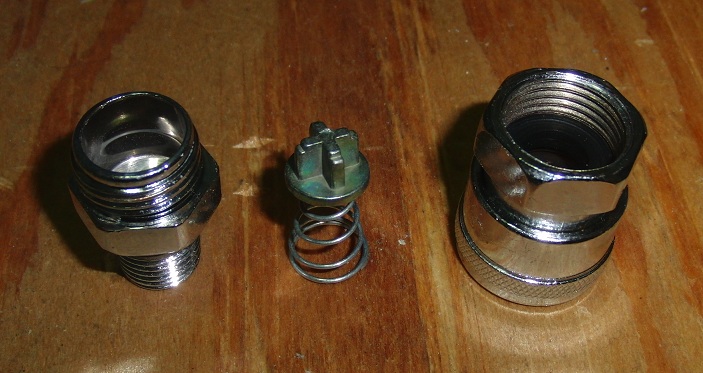

It was my thread that Gun Freak posted on. I just grabbed the spring with needle nose pliers and then used a screw driver and a hammer to knock the little thing out. Mine didn't unscrew either. hope this helps

That little check valve thing is very big on yours JSR. Mine was a tiny little cup sort of thing
