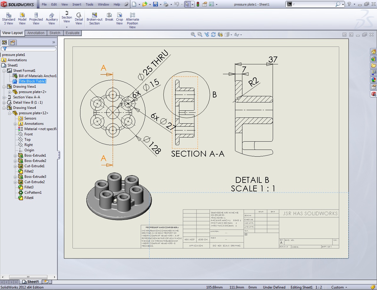

what licence did you buy? I'm lucky I'm a student, I can get it for free
... but this is for a commercial venture so standard license it is, costs an arm and a leg but from what I've seen so far, I can see the benefit

That looks like training not a real jsr design.
It was part of the tutorialal-xg wrote:Oh and hidden tangent edges, I must approve
oh shhh, I have a lot to learn before reaching your level of ability!I am to old for competition!
hehe let's not overreach ourselvesNow just to get him to learn Electronics, which is my real background.
Yup, finally getting close to living the dreamLathe, mill and pro 3D software all within a year.
Good luck on the future endeavor
Yeah it's the first tutorial, only just installed it so don't expect original renderings just yet.That looks like training not a real jsr design.

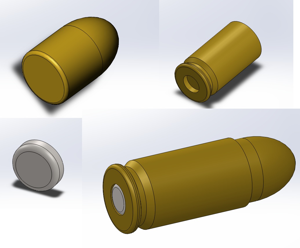

Edit: Had a bit of a play, here's my attempt at 9mm round

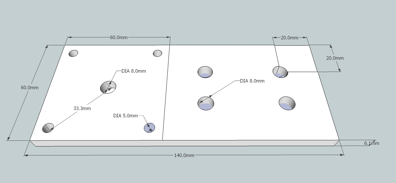

I need a three motor mount plates milled from 1/4" aluminium plate, any takers in the group ? Sketch attached.
Edit: The milling job is paid of course, sorry that wasn't stated up front.
