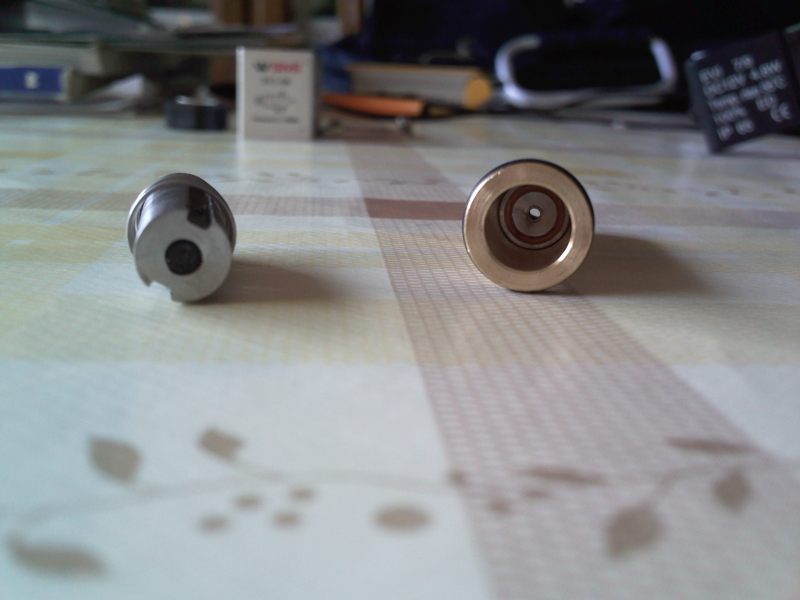

It means there is no way to "choose" the air flow, you can only open another way, so the air can go out in 2 ports, but one of them is always open
- POLAND_SPUD
- Posts: 5402
Unscrew the cap on top of it and check if there is a port thereIt means there is no way to "choose" the air flow, you can only open another way, so the air can go out in 2 ports, but one of them is always open
- wyz2285
- First Sergeant 2
- Posts: 2390
- Location: Porto, Portugal
- Has thanked: 1 time
- Been thanked: 4 times
Not exactlly a port... But it does leaks at there!!!check if there is a port there
- POLAND_SPUD
- Posts: 5402
yeah... if you blow air into one of the ports air goes through that port/opening... once the valve is energized air will flow from the port that was previously closed to the one that was connected with the top one earlier... so don't worry everything is okNot exactlly a port... But it does leaks at there!!!
are there any standard threads on the outside or inside that can be used ??
I have a bunch of similar valves (unfortunatelly all in 230V) and they are NC too...
some have and internal 5mm thread and I can used them as universal valves but the rest doesn't
(well apart from standard metric outside threads that are used with a nut to keep the solenoid in place... I'd need a female metric to bsp coupling or make one myself to use them as NO valves)

No I have opened te valve... It´s not a port. What a useless valve !!yeah... if you blow air into one of the ports air goes through that port/opening... once the valve is energized air will flow from the port that was previously closed to the one that was connected with the top one earlier... so don't worry everything is ok
- POLAND_SPUD
- Posts: 5402
well it isn't useless... you've simply got a valve that can't be used as a universal valve - that's all
it can still be useful for spudding don't worry
ohh and it's not unusual that there are two ports that are connected toghether - thx to that you can stack them toghether in a sort of manifold
- POLAND_SPUD
- Posts: 5402
thx
but hey it doesn't fail - it does exactly what it should -> it's a NC valve - that's all

What is a NC valve? Can it does something useful like pilot a 1/4 QEV?
- Gun Freak
- Lieutenant 5
- Posts: 4971
- Location: Florida
- Been thanked: 8 times
Normally closed, and yes.
- wyz2285
- First Sergeant 2
- Posts: 2390
It´s not a normally closed valve, it leaks from the top normally if charged from the front port. When powered, air comes out from the side ports(both of them as they are connected). I could tap the top and use it as a superb lame solenoid valve with less than 1mm D orifice

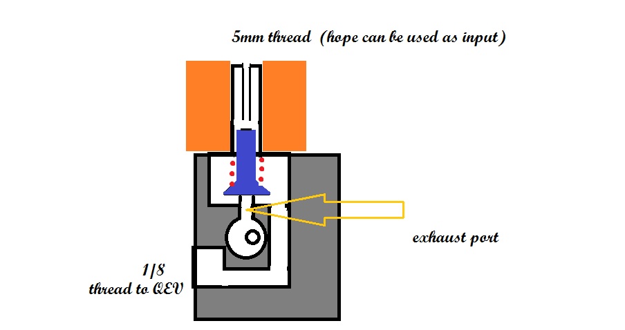

Here is the connection, anybody know how I can put this to work?
And I´m hoping this valve can be used as the following diagram, is that possible?
and the front port is A (exhaust - normally open to the exhaust)
that's almost exactly what your valve looks internally - the only question is.... is the third (top port) threaded?I´m hoping this valve can be used as the following diagram, is that possible?
