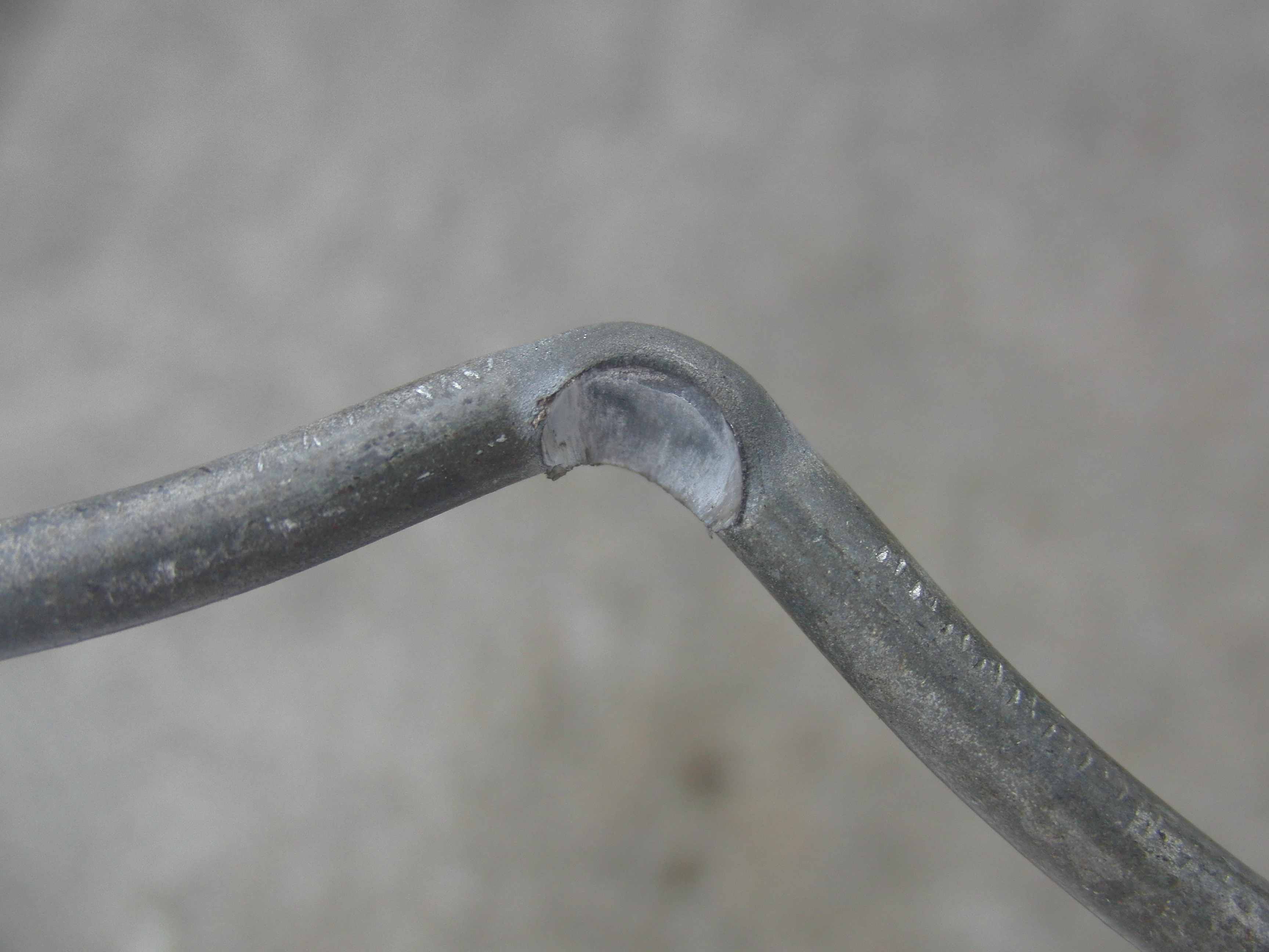

Went to my shooting location the last two days. First day I got good results. Today I didn't get a single result, all false readings on the chrony. After the last shot I think I found the problem, I may have been shooting wide or high.
What happened on the last shot? Well I shot a 10mm saboted ball bearing and it hit one of the 4mm metal guide rods (made from No.8 wire). I had a small adjustable woodworking bench to rest the gun on and stop it from moving side to side much but I guess upon ignition it still manages to jump around enough and throw off the aim even though i'm only 3m away from the chrony.

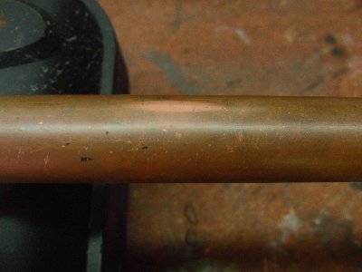

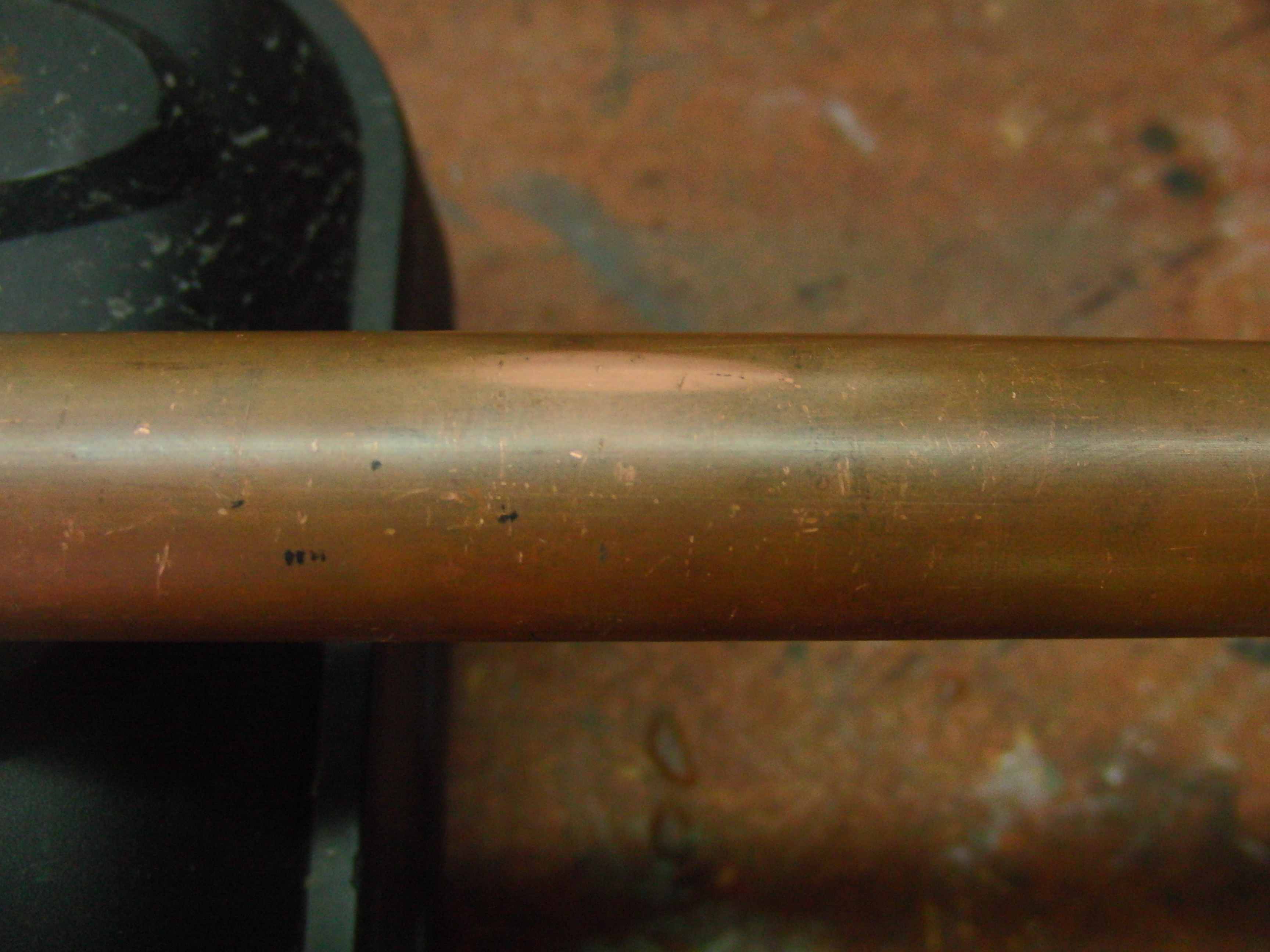

Oh and I noticed after the last shot there was a small bulge in the copper barrel, opinions people?

I'm no expert, but I think that barrel may tear open on you at some point soon. Maybe part of the sabot broke loose and smashed the side of the barrel.
- MrCrowley
- Posts: 10078
- Been thanked: 3 times
The sabot was a dense, hard foam so it's not that. Could be the projectile itself if the sabot was being torn apart inside the barrel.
