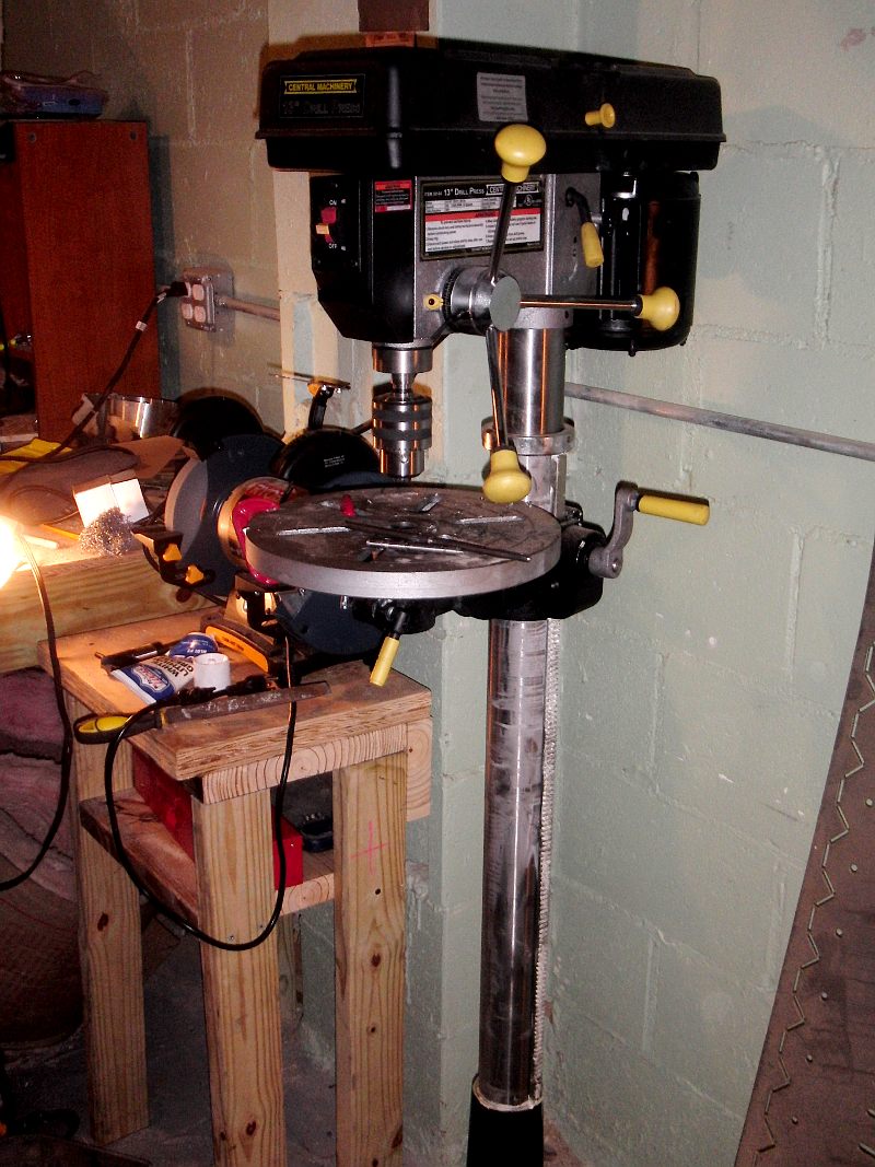

Alright, here's my preliminary review. I might be adding more details later as I discover them.
______________________________
http://www.harborfreight.com/heavy-duty ... 38144.html
Price: $299; may be marked down $50 or more when on sale.
Specs:
5/8” chuck
3 1/8" stroke
16 speed, 220 – 3600 rpm
120volt single-phase 3/4hp motor
Swivel table with 45degree tilt
62” overall height
Roughly 130lbs
This is Harbor Freight's medium-duty drill press, intended for average-joe garage use and light production work.

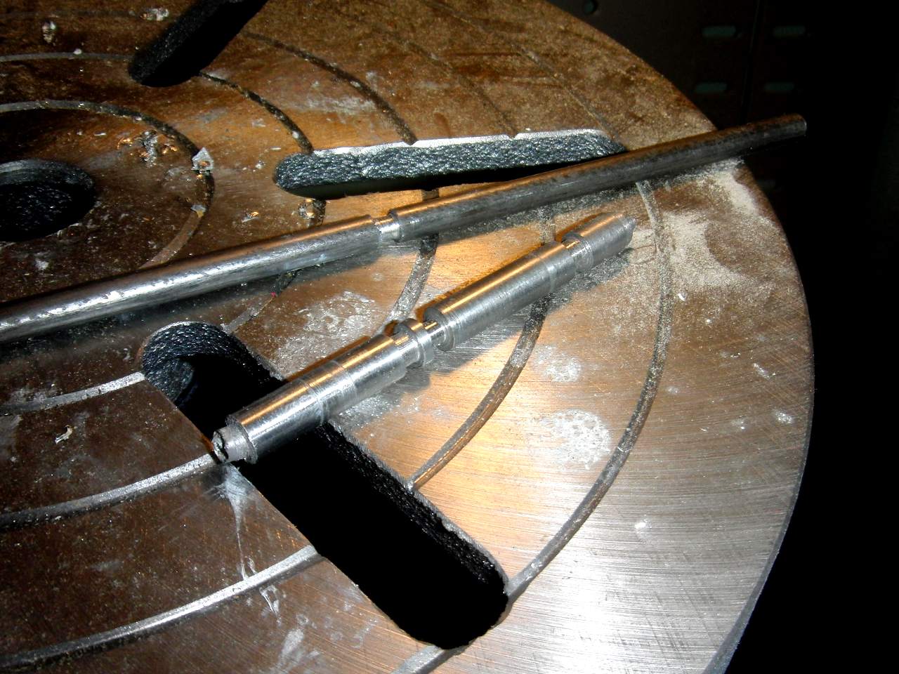

I have done some very limited turning tests on this, and found it can be used as a makeshift lathe, but the accuracy is not that good due to the spindle deflection. When turning some 5/16” stainless rod I noticed quite a lot of noise coming from the pulleys, though adjusting the tool angle reduces this some.
If you plan on using this as a lathe, get a cross-slide vise. I have not tried the harbor freight model, so I can't say. I would not say this is a replacement for a mini lathe; if you want to turn plastic or small metal stuff it'll be just fine, but as I said, the spindle deflection will reduce the tolerances you can achieve.

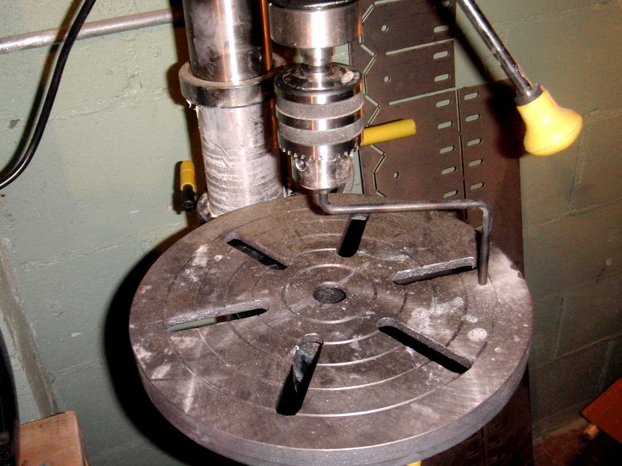

Oh, and for those of you not aware, here's a little trick for getting your table nice and level.<br />You'll figure it out.
As you can see, this can be used for small stuff. Try not to force your way through it too fast to prolong the life of your bearings.

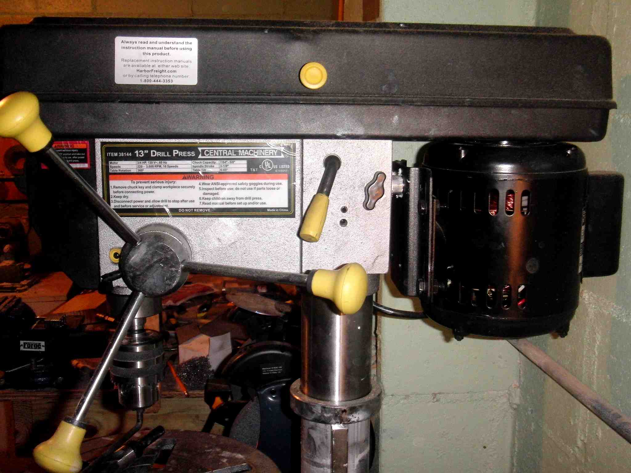

This motor is actually pretty beefy, though the bracket that holds it on isn't. It does look rather easy to replace or upgrade if the need arises.

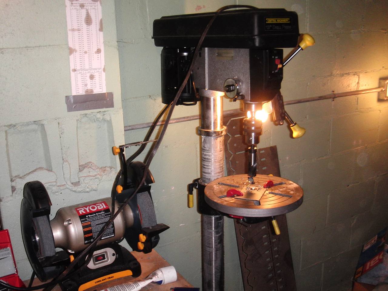

Also 8&amp;quot; bench grinder, newly acquired :)
Also 8&quot; bench grinder, newly acquired :)

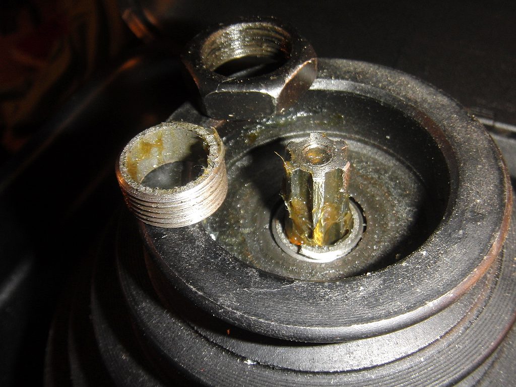

Update 20/ 2 /12
First defect discovered. We'll see what kind of reply I get from the HR guys.
Threaded rod snapped... self explanatory:
Pulley or spindle assembly? Can't really tell from the pic.

It's the foremost pulley, the one that drives the spindle.

Did you notice any unusual side to side play in the spindle?

Update 3/3/12
Replacement part is being shipped for free. HF Customer service has been a little slow in replying but otherwise pleasant to deal with. While I'm fixing the thing I'm going to see if I can modify it to avoid a similar failure in the future. I'm also going to try contacting the R&D department to get this thing re-engineered correctly. This is the only part of the press I've seen that looks way underbuilt, so it has to be a common failure point.
Note that in its current condition the press is still functional. The pulley slips under load, but applying significant belt tension can still allow you to drill mid-range stuff with no problem.

17/4/2012
Well guys, I broke another pulley insert a while back. I talked to the HF quality control guy and he said he'd test them out.
In an obviously thorough and comprehensive test, he drilled two 3/4" holes in mild steel and concluding that I could not have broken the insert in this manner.
From this I concluded he's either really, really busy or doesn't care. I'm not going to bother arguing anymore.
If anyone would be interested in machining me a new part from a decent alloy, please leave a reply. This might be tricky though, since I'm not sure how one would do the spindle engagement teeth.
I have parts on back order, but they'll be at least another month for whatever reason.
