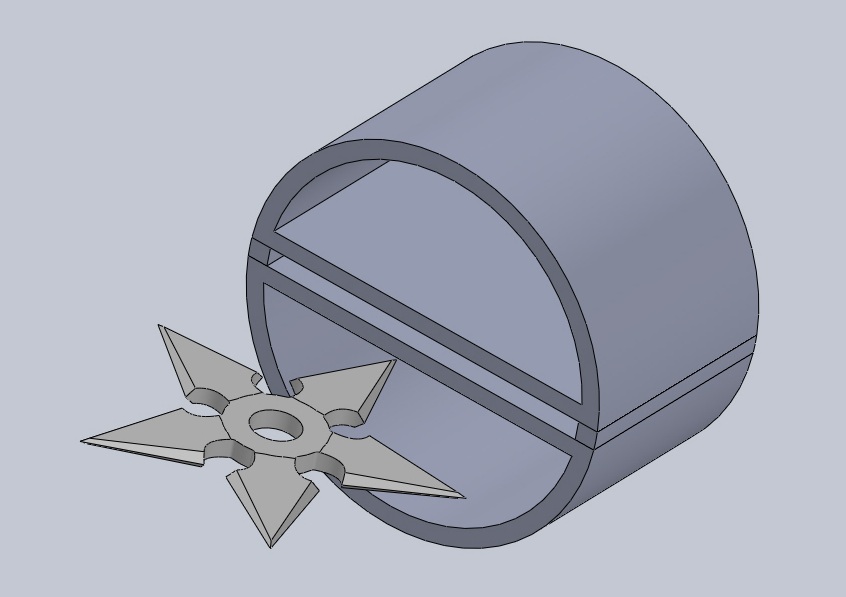

Since this is a spudgun forum, how about something like this though... just saying ;)

Lacking a means to induce rotation, the results would be poor to say the least. The basic shape is not aerodynamically stable. Once the sabot releases the shuriken will start to tumble almost immediately.
D_Hall wrote:Once the sabot releases the shuriken will start to tumble almost immediately.
tumbling = rotation
:D
This was just a bit of fun with solidworks anyway ;)

D_Hall wrote:Lacking a means to induce rotation, the results would be poor to say the least. The basic shape is not aerodynamically stable. Once the sabot releases the shuriken will start to tumble almost immediately.
True, potatoes aren't all that good either but it is the primary ammo of the spudgunner. It's still fun to see them "fly". If JSR's device could impart spin, it would work fine. We got them to stick in chipboard etc. You need to make them from 4140 heattreated or case harden mild steel as the points get beat up badly in a few minutes.
