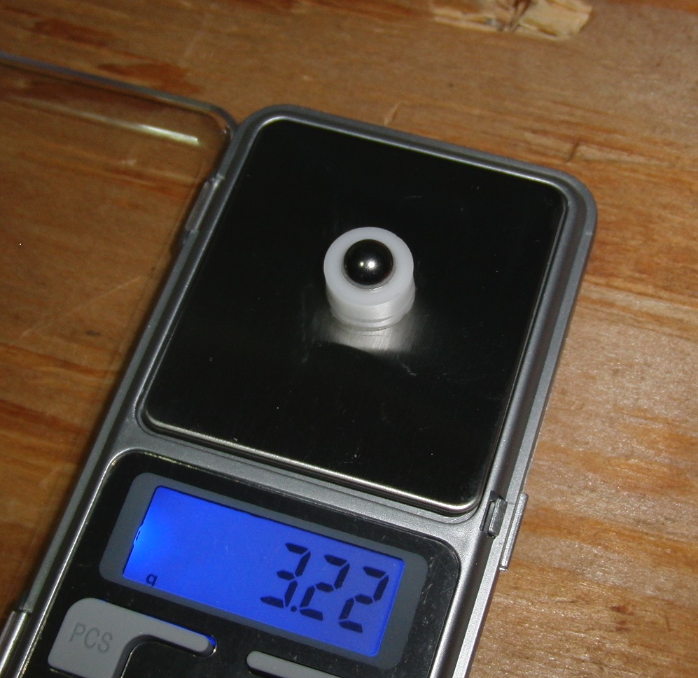

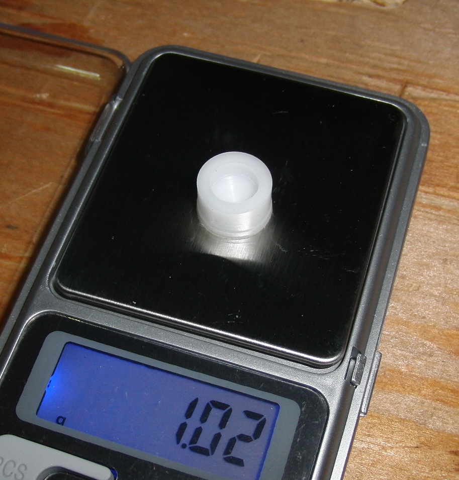

The problem is that this design won't really separate. It's probably best if I make some in three parts, one "pusher plate" and two "petals" to hold the ball. That way you will have a better change of recovering them for re-use.
With the force of the acceleration, the ball will dig into the sabot and will not separate.Petitlu wrote:If the ball is lightly glued, to the output of the barrel the sabot will go, no ?
3 part is more complicated and lengthy to make...
Not too complicated to make a three part one, I have a slitting saw on the mill
