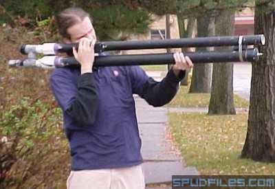

The compression chamber is 2" x 45". The control box features a triple safety: a labeled on-off toggle switch, and two buttons which must be pressed simultaneously to get the cannon to fire. The barrel I use most is a 1 1/2" x 48" barrel. I tapered the end to help cut the spud into shape. I also have a two inch barrel.

Set the control box against the firing barrel and use a small hose clamp to secure it. Then insert a block of wood or something similar near the business end of the launcher and use a large hose clamp to secure them.
Altogether, this cannon cost approximately $47. $12 for valve, $15 for pipe (sold in 10' sections) and fittings, and about $12 for batteries and electronic parts. It has been a while since I built this, so I cannot give you a more accurate price guide yet.

The completed launcher in action.

I actually made one of these. It is quick to assemble, easy to find parts for, and launches about 180 yards! I completely commend you on your excelent work. :D :D :D
