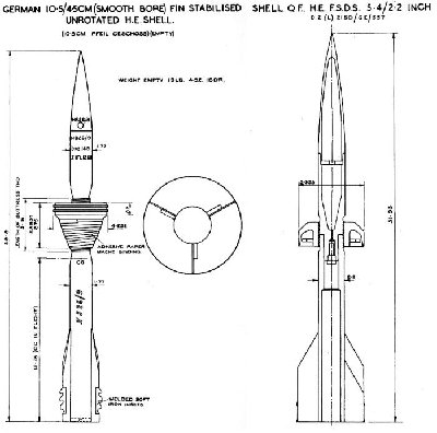

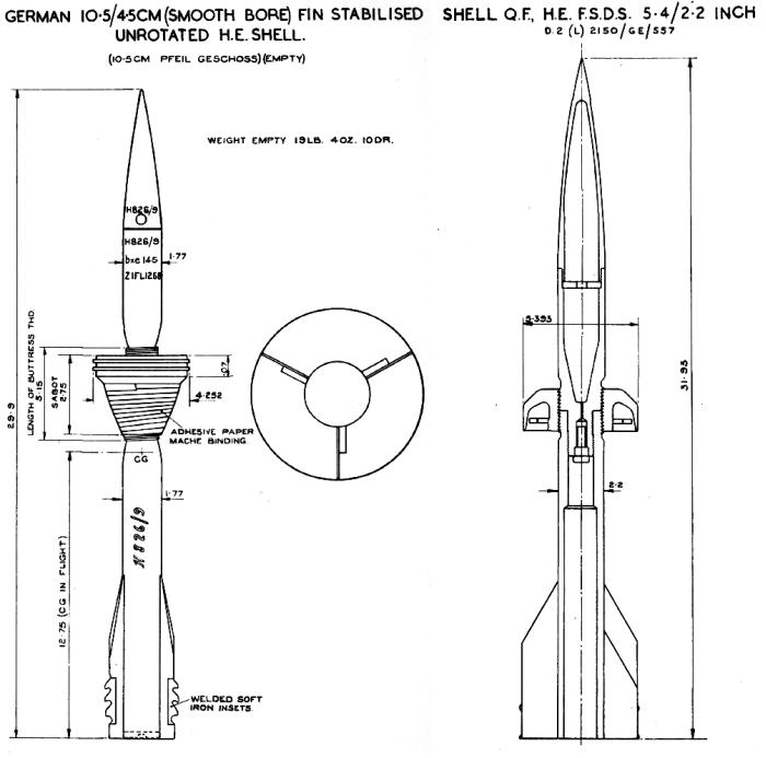

The Nazis were w-a-a-a-a-a-ay ahead of their time:
- POLAND_SPUD
- Posts: 5402
2:00 - 2:12 -> I think they explain what I meantioned earlier as far as gliding ammo is concerned - it needs some sort of guidance

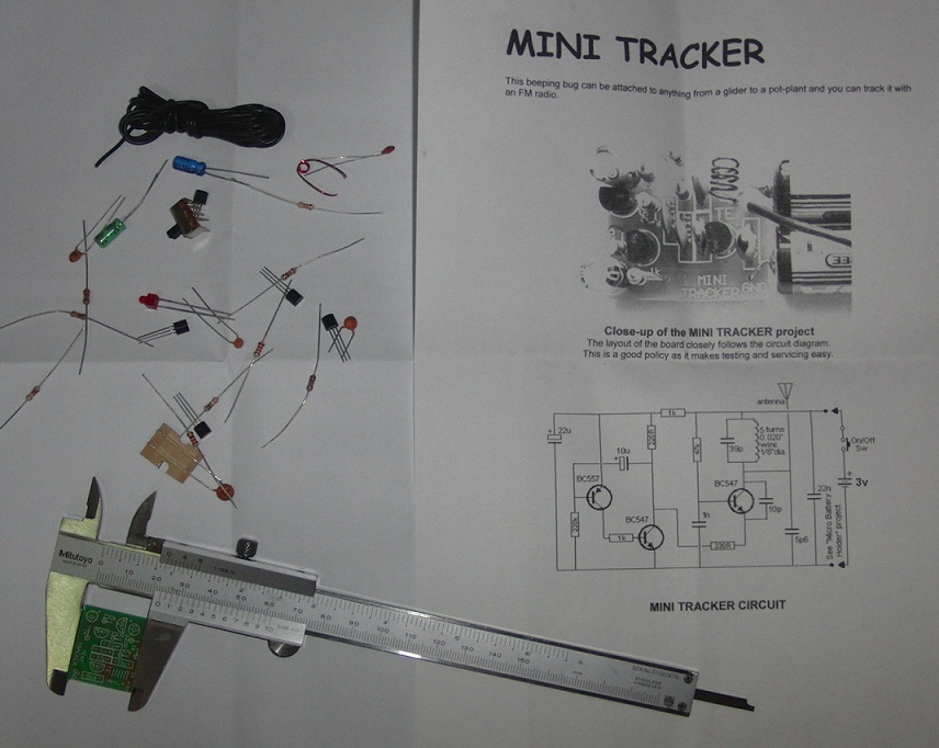

Dewey, help? I've never really put a circuit together before, any basic advice?
Pretty compact... my only concern is the coil, apparently it cannot be potted.

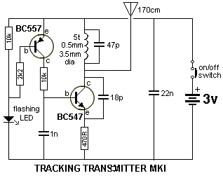

- The supplier suggested this as a simpler circuit, opinions? He supplied the parts to make it
- simplercircuit.PNG (8.77 KiB) Viewed 3566 times
Where to start?
Assuming you have a soldering iron of 25 to 50 Watt and the correct rosin core electronic solder (60-40 or 63-37) of about 1mm diameter then please start reading these links.
First: http://www.mil.ufl.edu/5666/6270/6.270B ... npter3.pdf
Second: http://www.1728.org/resisclr.htm
I recommend doing the coil as the last item to solder.
Build it to what the instruction sheet shows.
Post close up pictures of resistors or other components if you have problems with them.

Silly question, should I strip off the enamel at the point where I solder the coil?
Especially for translating the colour coding on the resistors...
Definitely yes.
