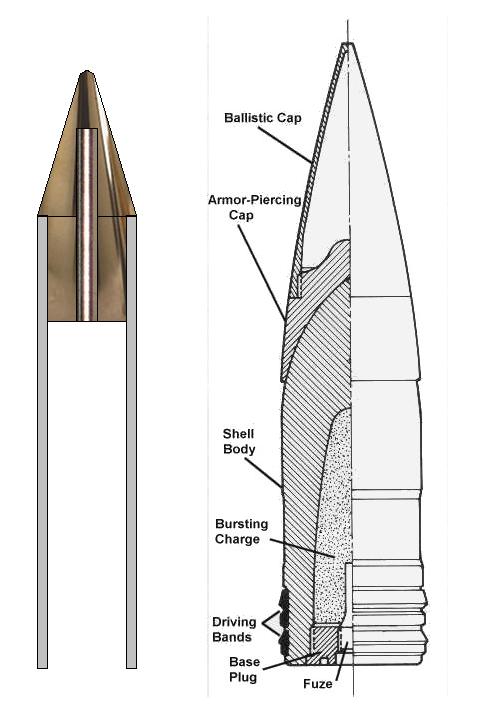

I'm surprised the stainless tip nearly made it through, impressive! It would be interesting to have a composite round, ie drilling a 6mm cavity in the steel tip and inserting a tungsten core.

But I do not understand the point of drill and put a tungsten rod as the tip does not open, the tungsten will remain inside ...

See the attached diagram, the tungsten will back the steel with something hard and dense, and at the same time the steel will make the tungsten less likely to shatter by absorbing some of the impact shock, like a capped shell which we discussed some pages ago.The stainless steel spike is impressive for sure!

I don't think that would make a difference. The reason it didn't penetrate is, apart from the hardness, becayse compared to the tungsten, it has a low sectional density.Against the body by aluminum could be replaced by a Delrin sabot because aluminum inhibits the penetration
For the tungsten rod it is 71g/cm<sup>2</sup>, if you had to make the same rod out of steel it would be about 39g/cm<sup>2</sup>.
A tungsten insert would increase this considerably, making it more likely to penetrate.

If not, don't worry, I'll make you the "ultimate APFSDS" composite round
I was thinking of an all-brass dart, with a central hole for the tungsten
hopefully I will have time for some lathe/mill therapy over the weekend...
