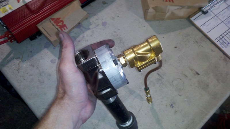

This valve started as a one inch diaphragm valve that has a bad cap and diaphragm. So, starting with just the valve body, I machined a cylinder and piston to convert it to a proper piston valve. I recently blew the diaphragm in an identical valve at 600 psi. So, I wanted to see how much pressure I could reliably run through this style valve with a machined aluminum piston and cylinder. Well, I have fired and fired and fired this thing (dry firing as you see it) all the way up to 750 psi without any problems. This thing sounds like a bomb when fired!
I have disassembled the valve numerous times looking for any damage or signs of premature wear and none are present. I am VERY pleased with this valve. I plan on making a one inch bore cannon with this valve firing slugs at 800 psi.
This valve is an experiment used to aquire knowledge on piston design and dynamics for my upcoming HPA coax pistol.
Anyway, enjoy the pics........
Matt
Experimental machined HPA 1 inch valve

Excellent job! It would be interesting to compare performance with the standard diaphragm valve.

Nice. I've only seen it done one other time. Great work.

I am in the process of converting my 1/2 inch bore rifle to use this valve. I will report back on the performance when I have more data.
I have fired the valve at over 800 psi at this point and it operates wonderfully.

I appreciate the kudos, though. I am also open to suggestions. I know this type of valve tends to have much turbulence through it due to the design. But, at these pressures, that condition is mitigated.
