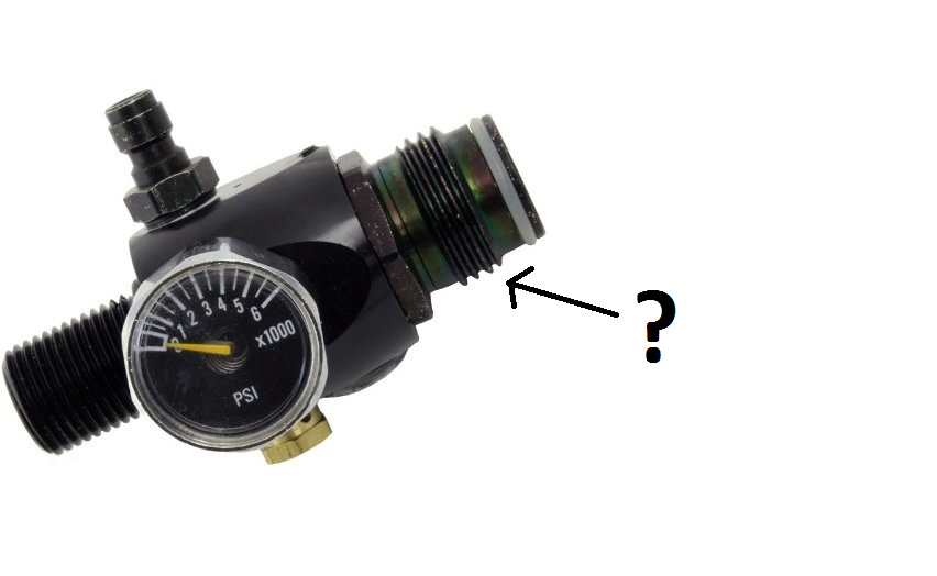

i need the exact thread dimensions as its critical it seals and it will be used at high pressure, i know its a non commercial tap size so ill set the lathe for internal threading,
this thread
this thread

1/2 BSP !

First result
But as said above, it fits 1/2" BSP.

I want the reg output, not the tank
threads which are 5/8" UNF and actually its 3/8" BSP that fits, JSR kindly gave me that link which has a 1/2" NPS tap but i found one at work, and will be machining them soon, i didn't want to use "similar" threads because it will be used at 800-1500 psi.

It's 1/4"-14, make sure your tap matches in TPI.

Im getting a Machinist to make it on the Hurco cnc, will post pictures in this thread tomorrow.
