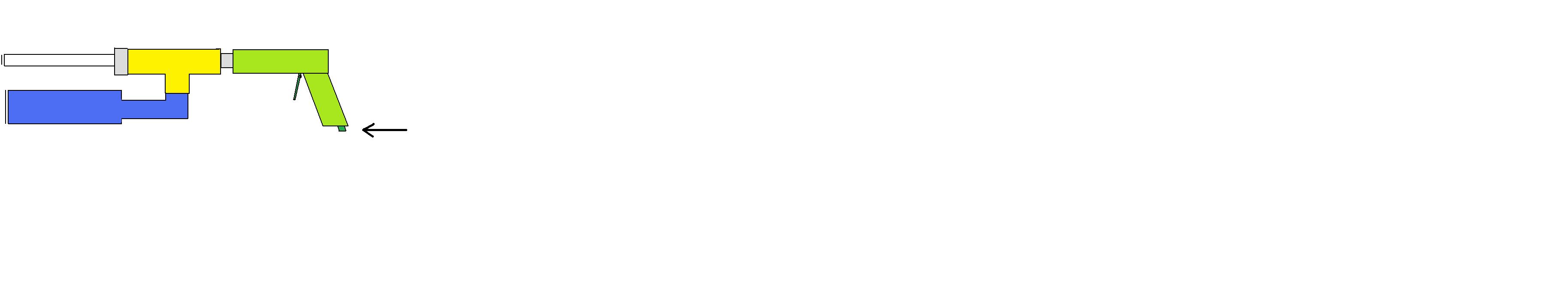

hi, i`m new here.please excuse my bad english and gramatics.
we have a simple selfmade qev,thats works very fine.behinde is the trigger(simpel air pressure-gun from a air compressor)
how we can it convert to semi auto?can we maybe somewhat built on the under side of the trigger-handel?
hope the pic ist shown.
please pics or links ?
greetings
Two options:
- use a "momentary" pilot valve, wyz on here modified a blowgun in this manner: http://www.spudfiles.com/forums/semi-au ... 21406.html
- use a three way valve as a pilot, and use a main chamber and firing chamber. Here's my example with commercially available parts: http://www.spudfiles.com/forums/semi-au ... 23626.html

hi,thanks a lot.
see i it right that i only must bild a valve "like this from the last pic" from the first link u have post?
