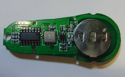

Send me closeup overhead pictures of both side of the recetver without the battery installed.
I can then read the parts used on it. Better with no flash.
Did you take pictures of the transmitter? If possible do the same thing with the images.

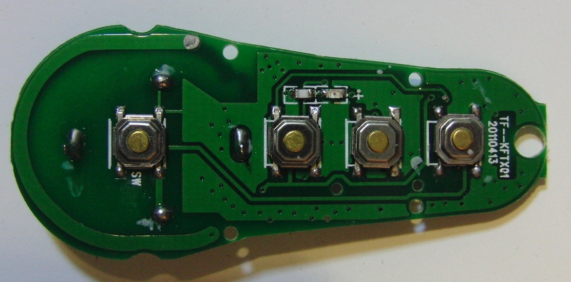

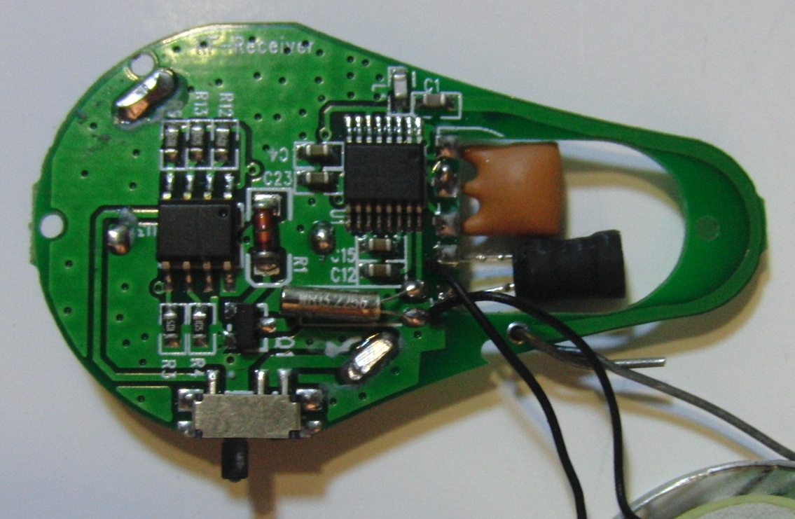

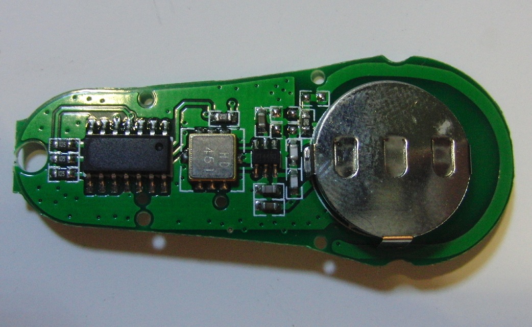

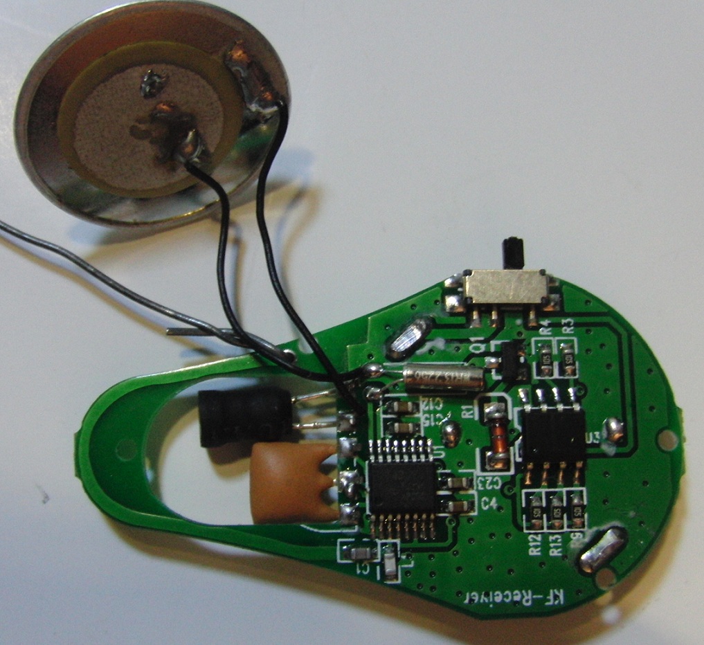

Some close up pictures of the transmitter and receiver. The bit of wire around the receiver board is something I added as an antenna. I tried bending it in various configurations, unsurprisingly having it straight worked best. Range increased about three times that in standard configuration.
A straight antenna is typically the best choice.
Adding a straight wire for the transmitter will also help.
The lengths of each should be equal. I could probably tell you optimal length if I knew the RF frequency.
Was there a manual/spec sheet with it?
I thought maybe the pictures would show the part numbers on the ICs.
I can tell that it uses 13.225600 MHz crystal.
It probably is 433.92 MHz therefore a 170mm antenna could be used.
nope, in typical eBay product style it was all bundled in an envelope with no packagingdewey-1 wrote:Was there a manual/spec sheet with it?
Only one of the ICs has visible markingsI thought maybe the pictures would show the part numbers on the ICs.
Good to knowI can tell that it uses 13.225600 MHz crystal.

What is the number on the IC? U1 or U3 of the receiver?
It appears to be a FM FSK receiver and transmitter.
freq= 13.2256MHz x 32 + 10.7MHz= 433.9192MHz or 433.92MHz.

It's U1What is the number on the IC? U1 or U3 of the receiver?
PT 4302-X
T8I3 1C (maybe)
APCS37
Here is data sheet for PT4302-x receiver IC.
The transmitter is probably the PT4450.
http://www.princeton.com.tw/
