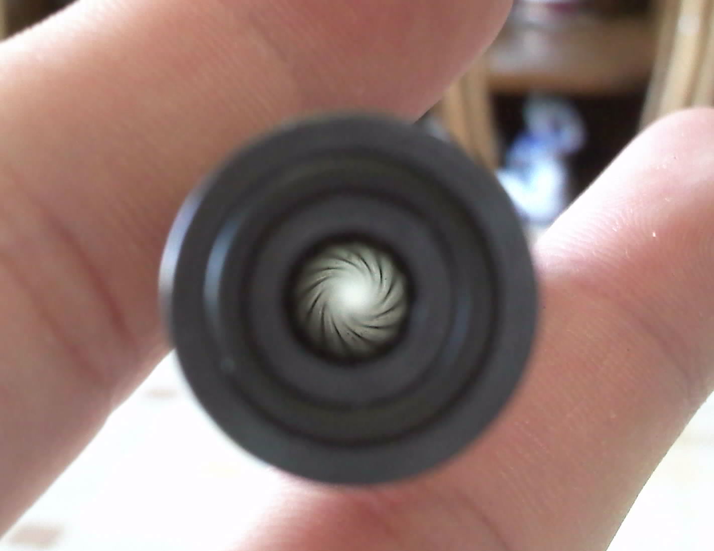

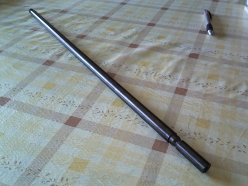

My weihrauch barrel arrived :D cost me 105euro total :roll:
Blued, chamfered, .177 cal 600mm.
The threading is on the muzze side, Gippeto you were right :) not a problem as I wasn´t planing on using it for barrel mount, handy for supressor mount through.

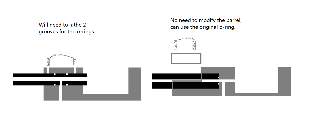

Now I have a problem, there is a pre-existent o-ring on the breech side of the barrel, apparently used to seal the barrel/breech connection. It looks good so I thought a new way to mount the barrel, as shown in the diagram. There is also a groove on the barrel that will help me to mount it. Any thoughts?
You can see the groove
barrel mount.png (22.69 KiB) Viewed 3875 times

Find a way to secure it nice and tight with the groove, and have it set up like the second diagram in the picture. I wouldn't modify it if I could help it.

Yap, sounds good and simple. Also the barrel is damn heavy, so to keep the gun balanced I may make it in a bull up configuration.

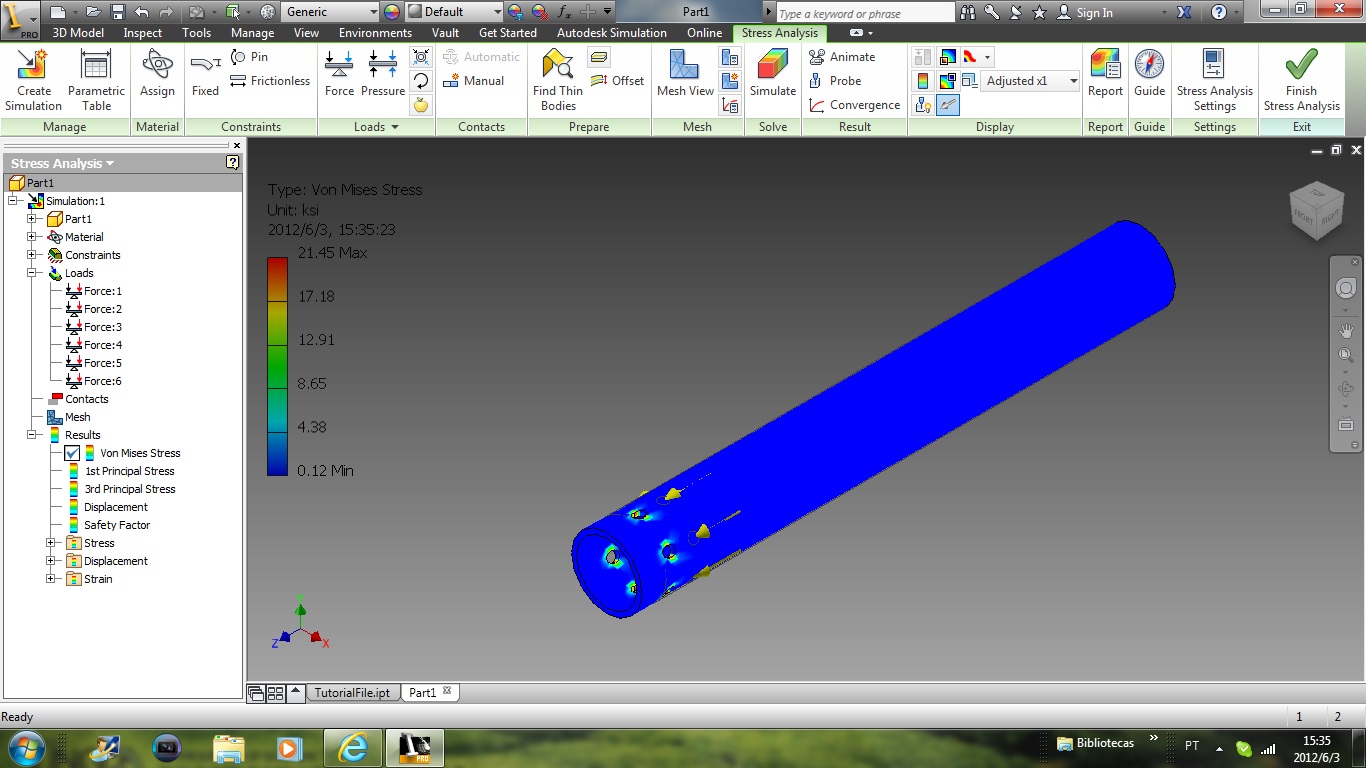

@Gippeto I'm having problem with the chamber as I was try to have the o-rings to isolate the threadings from the chamber pressure, but as the threading's depth, the chamber wall is unnecessarily thick, that would add a considerable weight. I will do a simulation about yield strength to see if the threadings are ok when exposed to chamber pressure.

Actually I have thought about having the head of the screw to take the load, didn't went any deeper through. Now I have to go back to study screw shear strength again :roll: Gippeto can you send me that link about screw shear strength? The old one isn't working anymore, says pahe not found.

Shear strength is an easy one, but not the only one you'll be needing.
To calculate shear failure, you need shear strength of the material and the area of the material.
For shear strength, use 60% of yield strength...ie if yield strength of the material is 100 000 psi then shear strength is 60 000 psi.
Although I build very much the same as Walter, I prefer to use the screws minor diameter for calculation. A common screw for me to use is either an 8-32 or 10-32 low head socket head cap screw with a yield strength of 160 000psi. These have larger head diameters that help with bearing stress on the tube...which we'll cover in another post.
For calculation, the shear yield strength of these screws is 96 000psi.
Minor diameter of an 8-32 is .140" for an area (pi*r*r) of .0154in2
Multiply area by shear yield strength.... .0154in2 * 96 000psi to get 1478.4 lbs which is the force required to cause a yield failure in shear.
The load on the fasteners holding the "plug" into your tube is calculated by multiplying the pressure in the reservoir by the surface area exposed to pressure. I use a safety factor of 3...so I'll use enough screws to ensure that the screws will yield at a minimum of 3x my maximum working pressure.
Making sense? :)
Bearing stress is next. :wink:
wyz2285
Austria
Posts: 2390
Location: Porto, Portugal
Yap that makes sense, I will do a FEA simulation :) by the way the unregulated part chamber maxim pressure will be 250 bar instead of 200, but I have checked the chamber yield strength, safe enough.
Edit, going to simulate the yield strength of 4 8-32 socket head screw in shear, also the bearing stress on the chamber wall.
wyz2285
Austria
Posts: 2390
Made a simulation about 4 10-32 screw on chamber, safety factor about 1.5.
Increased to 6 10-32, minium safety factor 4.66 :) chamber wall 2.5mm thick. Now I only have to calculate/simulate to see how deep the screw should be :)
