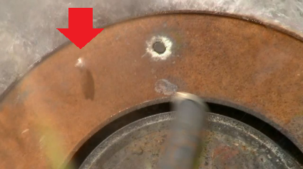

Total penetration: 15mm - D6mm
impact on the second disc and a slight hump on the back of the disk, as we see on a picture, the disc is cracked!
I am sure that without the projectile passed through the radial!

There was no chance of hitting in the radial ....
