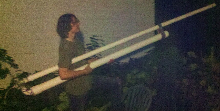

jackssmirkingrevenge wrote:Come on man, pictures ;)
if you insist, I was reluctant to add one because of the DWV fittings, but if any of you recognize me I hope you know I already know the risks and I used to oppose DWV fittings. just know that it's a risky but informed decision that I have made

an extremely handsome man holds his spudgun
iknowmy3tables wrote:just know that it's a risky but informed decision that I have made
It would be a shame if that handsome face had to be ruined by PVC shrapnel ;)
