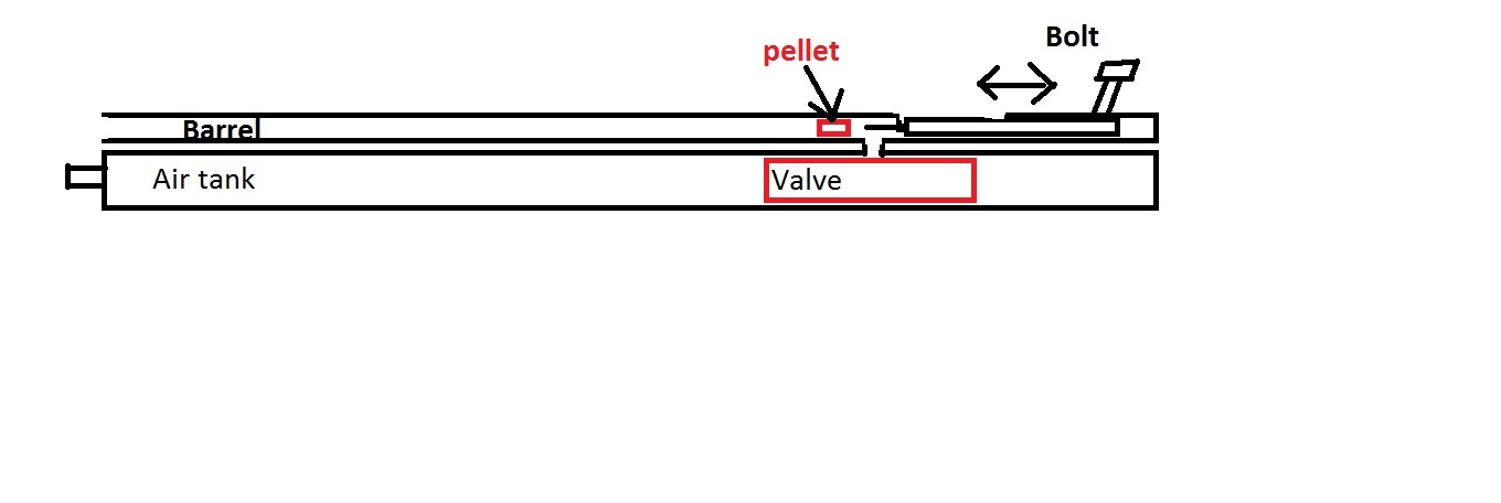

Hi
i am new at this forum but i have already build some airguns (i am not a noob at this).
I am trying to build a pellet pistol (single shooter 100 - 120 PSI ) but i need help whit the valve.
The vale has to be in the air chamber tube and release the air up from the tube where the barrel and pellet loading will be.
Has thanked: 581 times
Welcome to the forum, a diagram of what you are trying to achieve would be helpful as it's not really clear from your description.
Also, if you've made other pneumatic launchers, this forum has a showcase section if you want to show them off :)
ignatorius
Posts: 15
Joined: Thu Aug 23, 2012 8:13 am
This is the idea .
What sort of tools and materials do you have to hand?
A hammer valve would fit well in that setup, indeed it's how many precharged commercially available airguns are configured:
Alternatively, depending on the diameter of your air tank, a small quick exhaust valve could also fit in there.

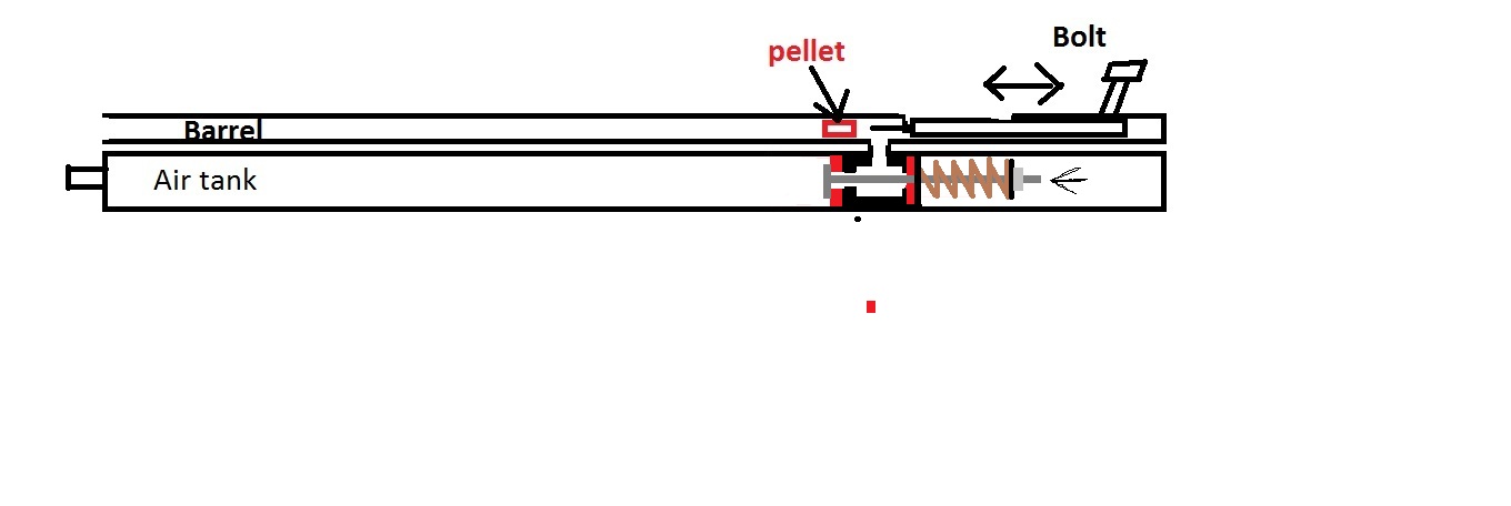

If the valve needs to be in the chamber tube, you could also make a small chamber-sealing piston valve :)

just made this valve, works great. :D
ignatorius wrote:just made this valve, works great. :D
Made the drawing or actually built it?! :?
ignatorius
Posts: 15
i made it not just draw it. going to make some photos and post them next day.
Labtecpower
Posts: 1297
Location: Pyongyang
Has thanked: 5 times
Been thanked: 13 times
assuming you're using a hammer to power the valve, connect your bolt to the hammer and you've made yourself a crosman system :D
ignatorius
Posts: 15
:lol: nah i will be using 120 psi only so i am thinking not to put a hammer but make a triger that will just push the valve .
That will be like using a blowgun directly as a valve. You can get fairly decent power if you "snatch" the trigger, but don't expect consistency and accuracy.
ignatorius
Posts: 15
jackssmirkingrevenge wrote:That will be like using a blowgun directly as a valve. You can get fairly decent power if you "snatch" the trigger, but don't expect consistency and accuracy.
so you suggest to use a hammer that opens the valve ?
pneumaticcannons
Posts: 392
Yes, otherwise, just buy a blowgun.
What caliber do you plan on using?
ignatorius
Posts: 15
pneumaticcannons wrote:Yes, otherwise, just buy a blowgun.
i am going to use 4.5 mm (0.177 cal) pellets. i am using 120 psi only so i gona make hammer that opens the valve long enough to let all the air come out.
ignatorius
Posts: 15
This is the valve that i made. No leaks, works great.
