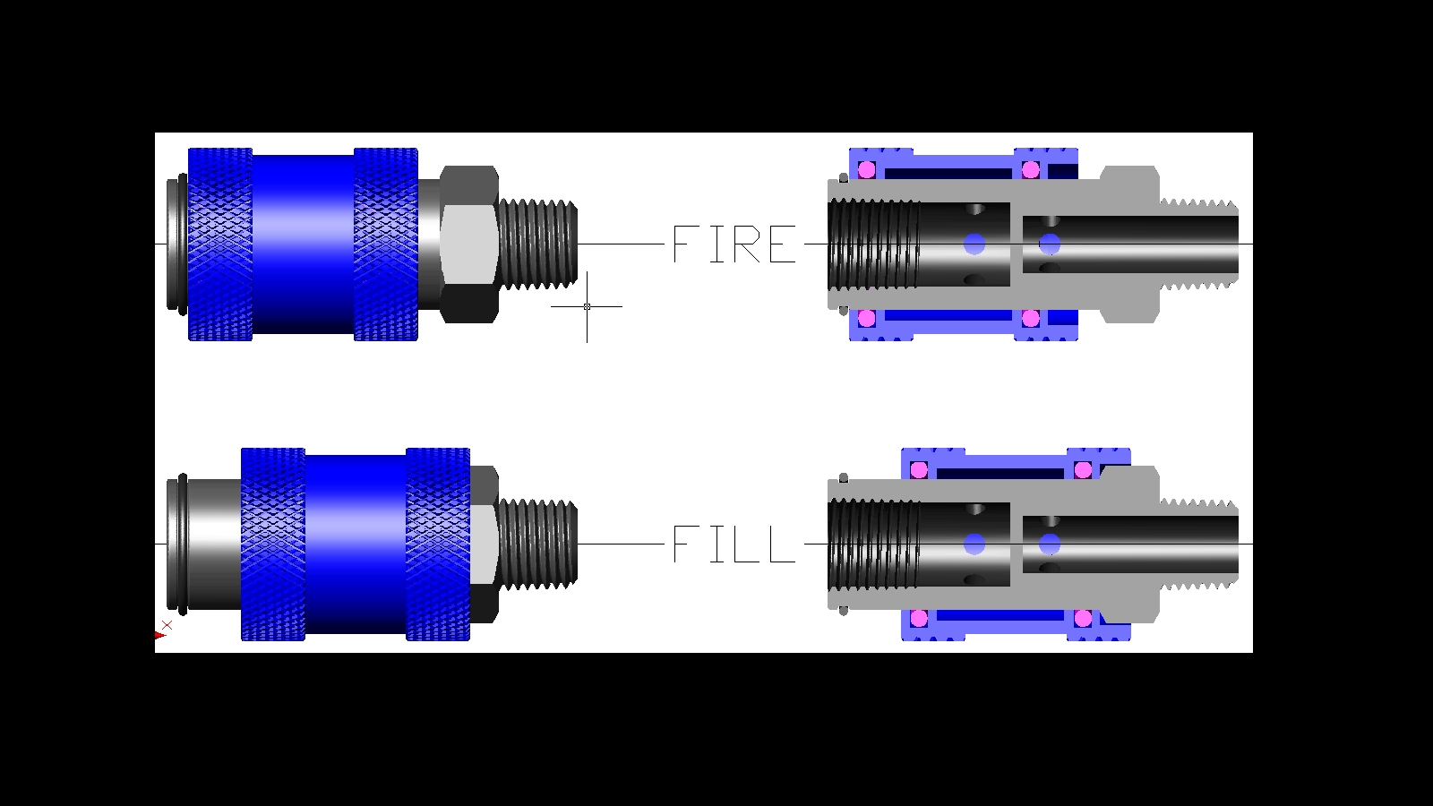

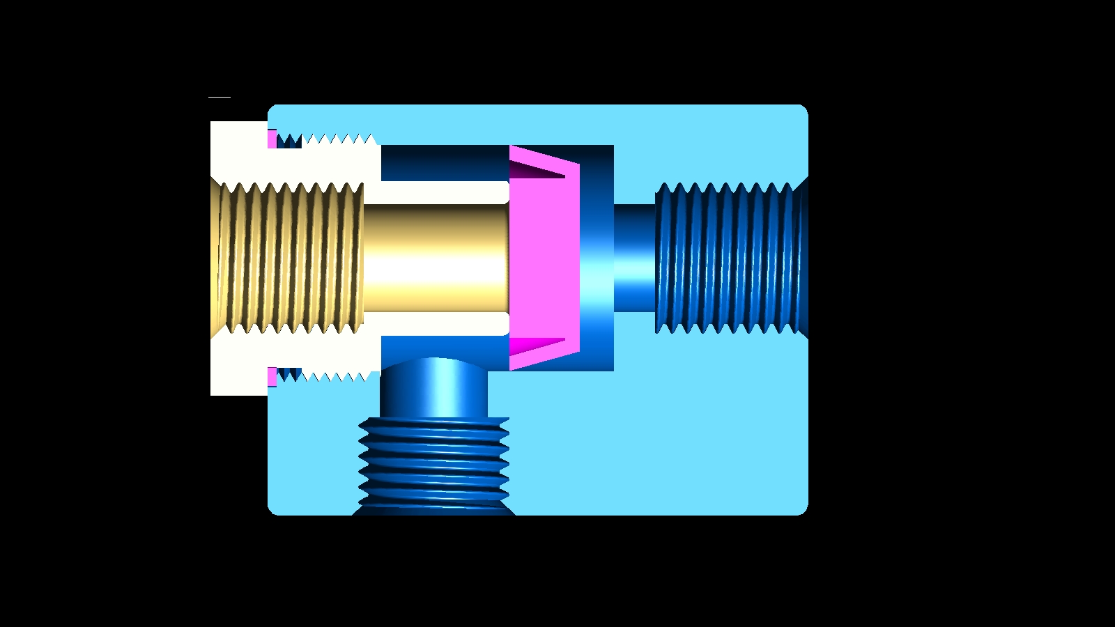

Here is CAD rendering for QE-02 and slide valve.
If any one one wants .sat file please PM me.

dewey-1
Posts: 1298
Location: NE Wisconsin USA
Thanks JSR.
I added the slide valve while you were posting. :)
So I see, that I can take a bit of credit for :)
dewey-1
Posts: 1298
You can have all the credit except for the threads and knurling! :D
*bows*
Added them to the first page. Can you do section views? I tried in SW but it's a uniform grey colour...

dewey-1
Posts: 1298
jackssmirkingrevenge wrote: Can you do section views? I tried in SW but it's a uniform grey colour...
Done!
I can not believe you can not do colors with SW.
There must be a way to do that.
Cheers! first page updated :)
When I open the .sat file in SW I cannot differenciate between individual components...
